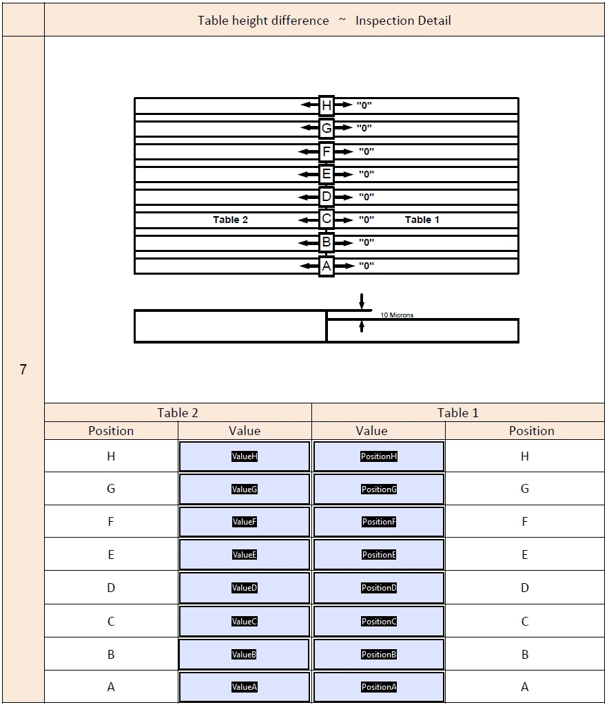

Help with positive and or negative data put into a field
Can someone please help me , I have 10 fields which are populated with measured data.
The data can be positive or negative, but not greater than -10 or +10
If the data being measured is put into any of the fields, is less than or =  -10  / + 10 then I want to populate another field with "pass"
but if the data being put into any of the fields is greater than -10 /+10 then I want to populate the other field with "fail"
This is measured data,microns so can be positive or negative.
Many thanks

really appreciate your response, forgive me if I am wrong but your answer applies to one field
I have 8 fields that all need to be between -10 micron and 10 micron.
How could I write the above the 8 different fields

Hello, Karl Heinz Kremer
I tried your script for 8 fields
var h = this.getField("ValueH").value;
var g = this.getField("ValueG").value;
var f = this.getField("ValueF").value;
var e = this.getField("ValueE").value;
var d = this.getField("ValueD").value;
var b = this.getField("ValueB").value;
var a = this.getField("ValueA").value;
if(h==""&&g==""&&f==""&&e==""&&d==""&&c==""&&b==""&&a=="") {
event.value="";
else if (Math.abs(h,g,f,e,d,c,b,a) >  10){
event.value "Fail";
else if (Math.abs(h,g,f,e,d,c,b,a) < = 10) {
event.value = "Pass";
But I get an error on line 12 ; missing statement
any help please
Stef
June 29, 2017
You can't replace abs(one thing) with abs(list,of,many,things). You need separate abs for each value. You have to connect them with && (and) or || (or); think about which one is right.
