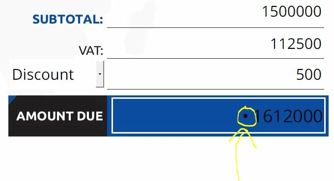

but instead, i get a bullet circle symbol on the field. i have used three different font type: "Open Sans", "Helvetica", and "Arial" but none of them gave me the sign, i have equally worked another clean page with a singular form field, yet i got the same result.

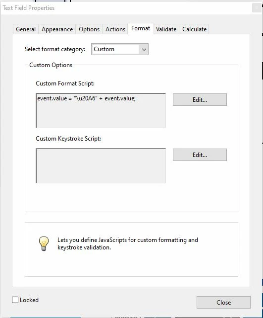

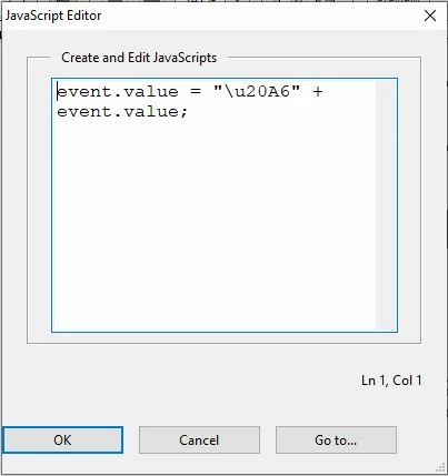

Thank you so much try67, am very grateful for your response, but i have entered this script and it is still not giving me the symbol, instead i get a bullet circle sign like the picture below:
this is exactly how i entered the script in the custom format page below:
please is there anything I am not doing right here?
i have equally used this:
event.value = String.fromCharCode(0x20A6) + event.value;
but still it didn't work.
