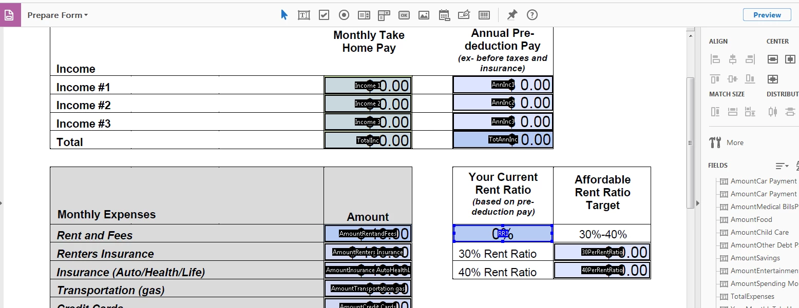

      I'm working on a fillable pdf budget sheet. I want to add in formulas to calculate percentages. I found the code below to remove my "Warning: Javascript Window" issue from a previous forum article. I also want to add in the equation "AmountRentandFees/(TotAnnInc/12)". It works as a stand alone equation but it does not work with the code below. Is there a way that I can use both?? I'm not JavaScript savvy. Any simple ideas people may have would be greatly appreciated! Thanks!
Pat

Hi George!
     Much thanks for your reply! Right now, I have it set up so that someone will enter a value into a text box ("TotAnnInc") that totals their annual pre-deduction pay (gross income). The formula then takes what the tenant is paying in rent ("AmountRentandFees") and calculates their housing ratio (a percentage). I have this part working just great. However, whenever I save the pdf and start using it, it sends me the "Warning: Javascript Window" alert repeatedly. This alert makes it cumbersome to enter other values into the pdf until I enter in the total annual income ("TotAnnInc"). I found the above code to silence the "Warning: Javascript Window" but then it won't calculate the housing ratio. Does that make sense? Any wisdom you have to share would be greatly appreciated.
      pat
