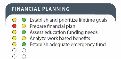

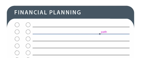

I'm trying to create a fillable form where there are two circle shapes and a line of text next to them - somewhat of a timeline checklist. I'd like my team to be able to change the color of the circles from white to either red, yellow or green - preferably via a drop down. If drop down isn't available, that's fine, but I need another solution BESIDES making color-filled comment shapes. These are checklists that we'll be customizing many times a week so we need to make it as user-friendly as possible.
This is a closeup of the template that needs to be a form with editable colors:
And this is what it should look like once edited, as a deliverable:

This is possible using form fields, but it's not a built-in behavior, so you have to fake it using JavaScript. Here are links to some demos that illustrate aspects of this approach:
http://acroscript.net/pdf/demos/multistate_4.pdf
http://acroscript.net/pdf/demos/button_checkbox.pdf
So the idea is to set up each circle as a button and use JavaScript to cycle through the various colors you want to use when each is clicked, so you're faking a multistate check box.
For the lines, it might make sense to leave them off or use a script to remove the underline once a field is filled in. A custom validation script for such a text field might be:
// Custom validation script for a text field
event.target.strokeColor = event.value ? color.transparent : color.black;
This assumes the border style is set to underline.
