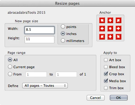

You can bypass Acrobat's cropping limitation by using the Resize Pages feature of my free abracadabraTools:
http://abracadabrapdf.net/utilities-in-english/acrobat-utilities/abracadabratools_en/
