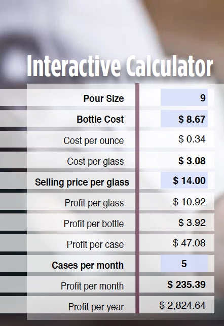

I have set up an interactive Cost per Glass calculator and I cannot figure out how to write the code for my profit per bottle:
(profitperglass*25.36)/poursize
I also tried to set it up with the 25.36 as a variable field that I reference but it still doesn't work. (25.36 is the number of ounces in the bottle)
I was able to make a file with the Pour size as a set number but now I want the pour size to be a fillable variable that will then affect their profit.
All the other calculations are input in the "Value is..." and the "Simplified fields..."
I don't know where or how to do this one.
It is possible, I can do it in excel?

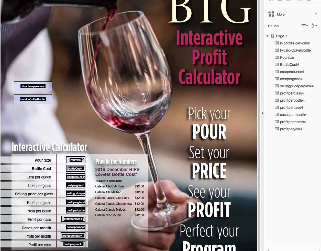

Karl Heinz  Kremer
November 28, 2016
The field names are case sensitive, so "Poursize" is different than "poursize". Also, it looks like you don't have a field named "profitperglass" - it's "profitperglass4". You should be able to use the following forumula in the "simplified field notation" field:
(profitperglass4 * 25.36) / Poursize
