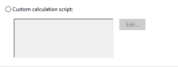

traceyh53384130
May 30, 2019 2:54 PM UTC
I'm brand new to Adobe, so unsure of where to put the script and make it work.  I went into custom script and edit and pasted the script you had written.  also brand new at calculations, so sorry if I sound stupid.
when you say fields in your script, does that mean I put my fields everywhere it says fields?  below are the fields I am looking at
try67
May 30, 2019 3:02 PM UTC
Yes, this code should be used as the custom calculation script of the field where you want to show the result.
You need to enter the names of the fields, between quotes, into the fields array, yes.
Give it a try and post here how it goes... If it's not working correctly press Ctrl+J and check if there are any error messages in the window that opens.
