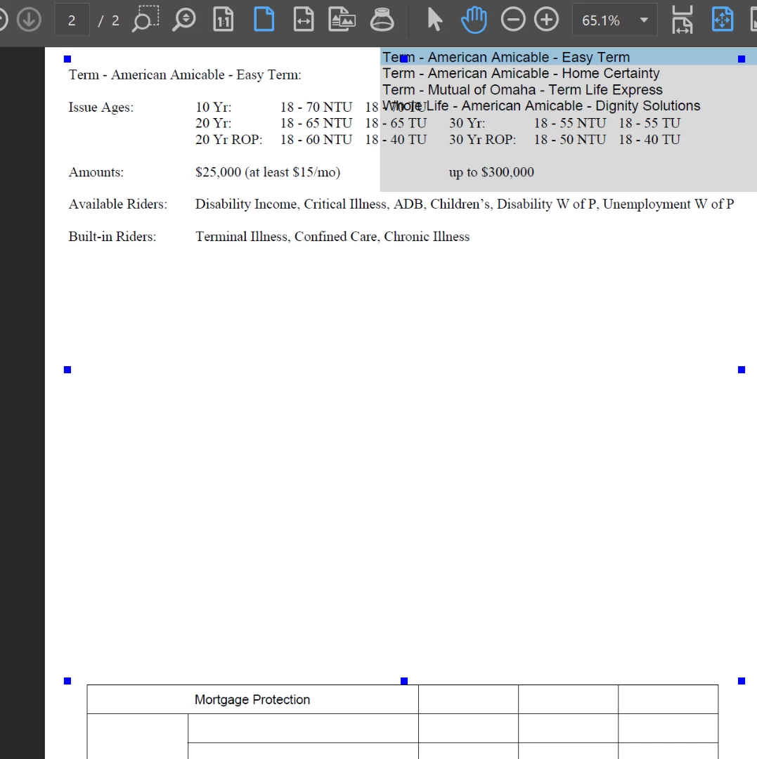

How to change the font of a specific variable?
Rich text formatting is selected.
this is a javascript question.
This is a calculated field for a form field.
I just want 1 variable, no array needed. I would like my variable to be bold, centered, and larger font.
What I currently have... which do nothing...
var val = getField("Products").value;
val.alignment = "center";
val.fontStyle = font.TimesB
nathanm54209085Correct answer

(function () {
    // Initialize some variables
    var i, aLines = [];
    // Associate states with a description
    var oDescriptions = {
"Term" : "\nIssue Ages:\t\t10 Y",
"Term - Am" : "This",
"Term - " : "\nIssue Ag",
"Whole Life - Amer" : "This is a whole life"
    // Get the selections from the list box
    var val = getField("Products").;
    if (typeof val === "object") {
        for (i = 0; i < val.length; i += 1) {
            aLines.push(val + ":\n\t " + oDescriptions[val] + "\n====================================================================================");
    } else {
        aLines.push(val + ":\n\t " + oDescriptions[val]);
    // Set this field value
    event.value = aLines.join("\r");

May 25, 2017
You don't actually need Rich Text to be checked if you aren't going to have multiple styles in the field. The problem you are having is that you are trying to set field properties on the field value rather than the field object itself. You were also using the wrong property name for the font.
See corrected code below.
var val = this.getField("Products");
val.textFont = font.TimesB
May 25, 2017
Thanks for the correction... nothing happened. The entire field is still left aligned and not bold
Joel Geraci
May 25, 2017
Where exactly are you putting the code?
