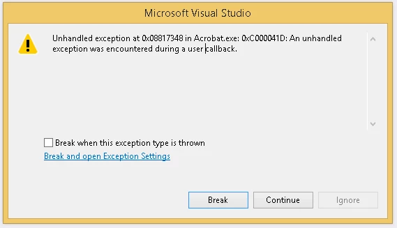

For your more information, when Acrobat crashes when I scroll, and if use the Acrobat debug option to debug it, it gives me below error:
But for my above logic, there is not any callbacks that I have written.
And Acrobat crashes when It is scrolled somewhat.
What is the cause of this error?
Thank you in advance!
