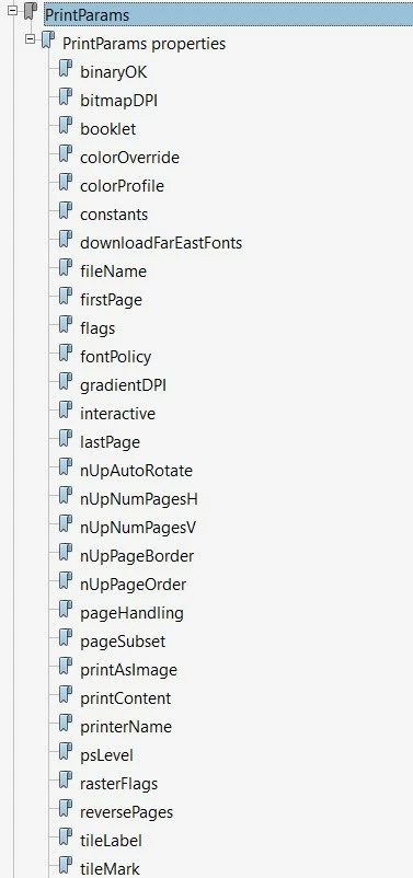

I need to print my PDF Document via JavaScript.
These are my printParams which I use and which works very well:
              pp.interactive = pp.constants.interactionLevel.silent;
              pp.firstPage = 0;
              pp.lastPage = 0;
              pp.pageHandling = pp.constants.handling.fit;
              pp.nUpAutoRotate = true;
Is there any possible Java Code which makes it possible to rotate my print page from vertical to horizonal?

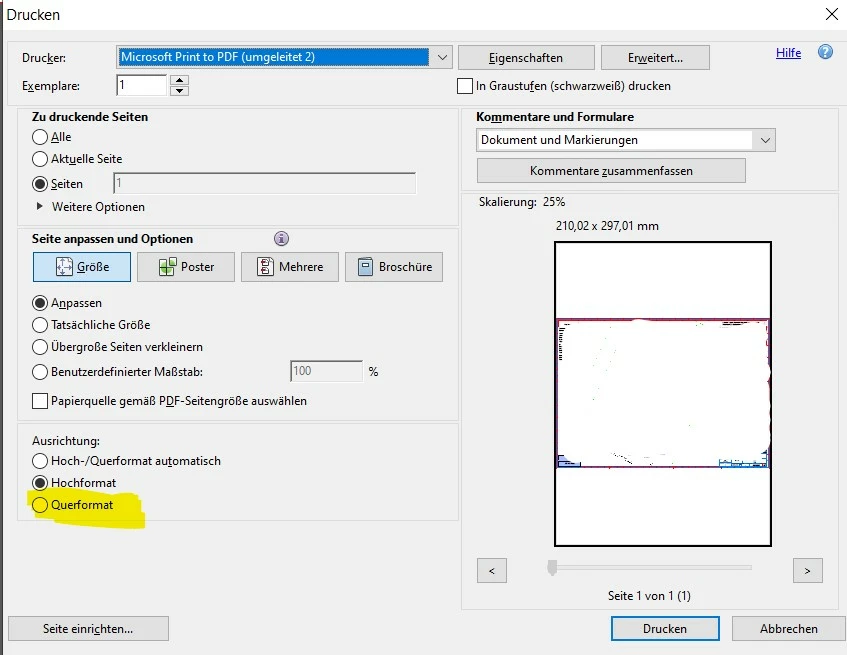

thanks for yout idea. I tried your code and different variations of it but it doesnt work. I will show you what I have done. I run the following script:
this.print({
bUI:true,
nStart:0,
nEnd:0,
bShrinkToFit:true
setPageRotations:(0,10,90)
but the print option(look at my screenshot) does not switch to horizontal (yellow marked area). I need to turn ON the yellow marked option by javascript.
Thankyou and Best regards
try67
Feb 23, 2021 8:56 AM UTC
setPageRotations has nothing to do with the print command. It's its own command to rotate the pages.
You should use the code provided by ls_rbls, before calling the print command (and after, if you want to rotate the pages back to their original views).
