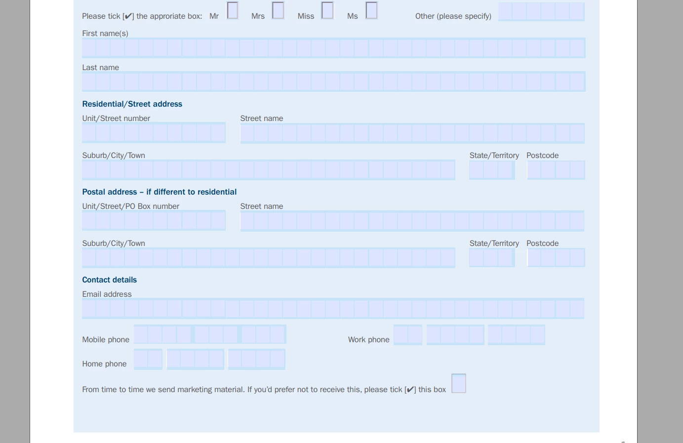

The PDF form is like:
What I don't know are :
1. how to import a pdf in this code
2. export this pdf after filling that data above
Thank you so much for any help!
