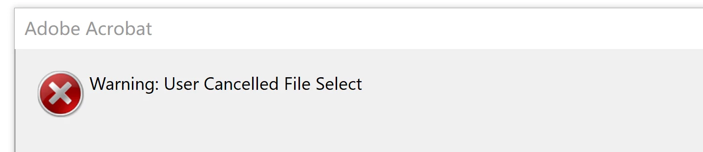

But there is still a question that I do not know how to figure it out.  According to Batch-Import List Data into PDF Form - KHKonsulting LLC
I try to modify the code but it always shows "User Cancelled File Select" error when I use custom command in Acrobat DC.

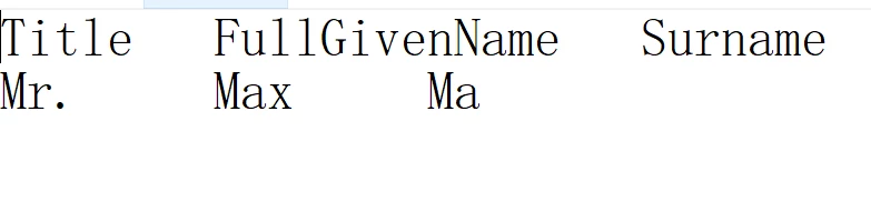

My data list is like(tab delimited text file): Only one row

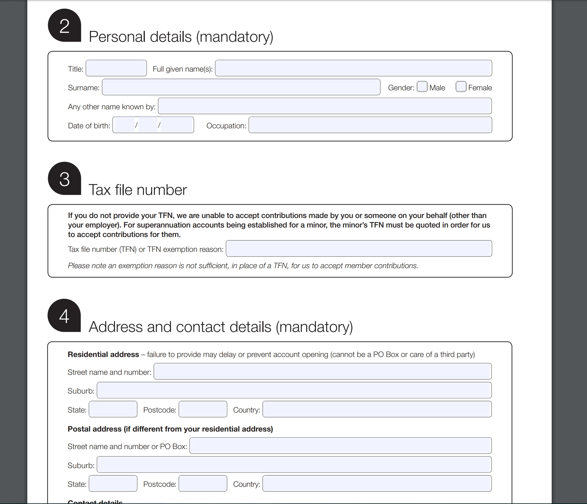

My form is like: (fillable form)

And it shows when I click the custom command created button:
I have no idea about how to solve it. Really need some help for that. Thank you for any advice.

My experience is that almost all problems are caused by a mismatch between form fields and data file. You need exactly the same number of columns with data in you text file as you have fields in your document. The data column names also have to match the field names exactly. If this is not the case, you will end up with errors. The best way to figure out what data columns you need is to fill your form with sample data and then export the data to a text field. This will show you how your data file needs to look. The order of the columns is not important, but everything else needs to match.

The form is below. Just as the code I put above, what I need to do is only to fill one field, not all(e.g. Title field). So do I also need to fill every field on this page and export the data?
Another question is:
You said that "You need exactly the same number of columns with data in you text file as you have fields in your document." But in my case, this form is a little bit different from your sample form because the columns are not regular and atactic. So I don't know how to calculate the number of the columns. In your sample, the data is : one column has many data(fields), e.g. many email addresses under "email column", my case is each fillable blank only need to be filled with one field, e.g. only "Mr." is under "Title".

Regardless of how many fields you want to fill with data, your data file needs to have data (which can be an empty string) for _ALL_ fields in the document. There is no way around that. Again, export data from your file to see what the file needs to look like.
Yes, your form is different, that's why I was referring you to a different post, which is for "normal" (and not table based) forms.

Based on your statement that you only want to fill the form with one row of data, and the way your form looks (from the limited screenshot in your question), I assume you are using the wrong approach. The blog post you referred to is about importing data into a table in your PDF file, you don't necessarily have table data, you have a "normal" form, so the approach outlined in Batch-Import Excel Data into PDF Forms - KHKonsulting LLC​ would be better suited for your form. What I said before about the data file and the form needing to match exactly holds still true.

Your text file has only one data row. You will get this error when you try reading a second data row.
