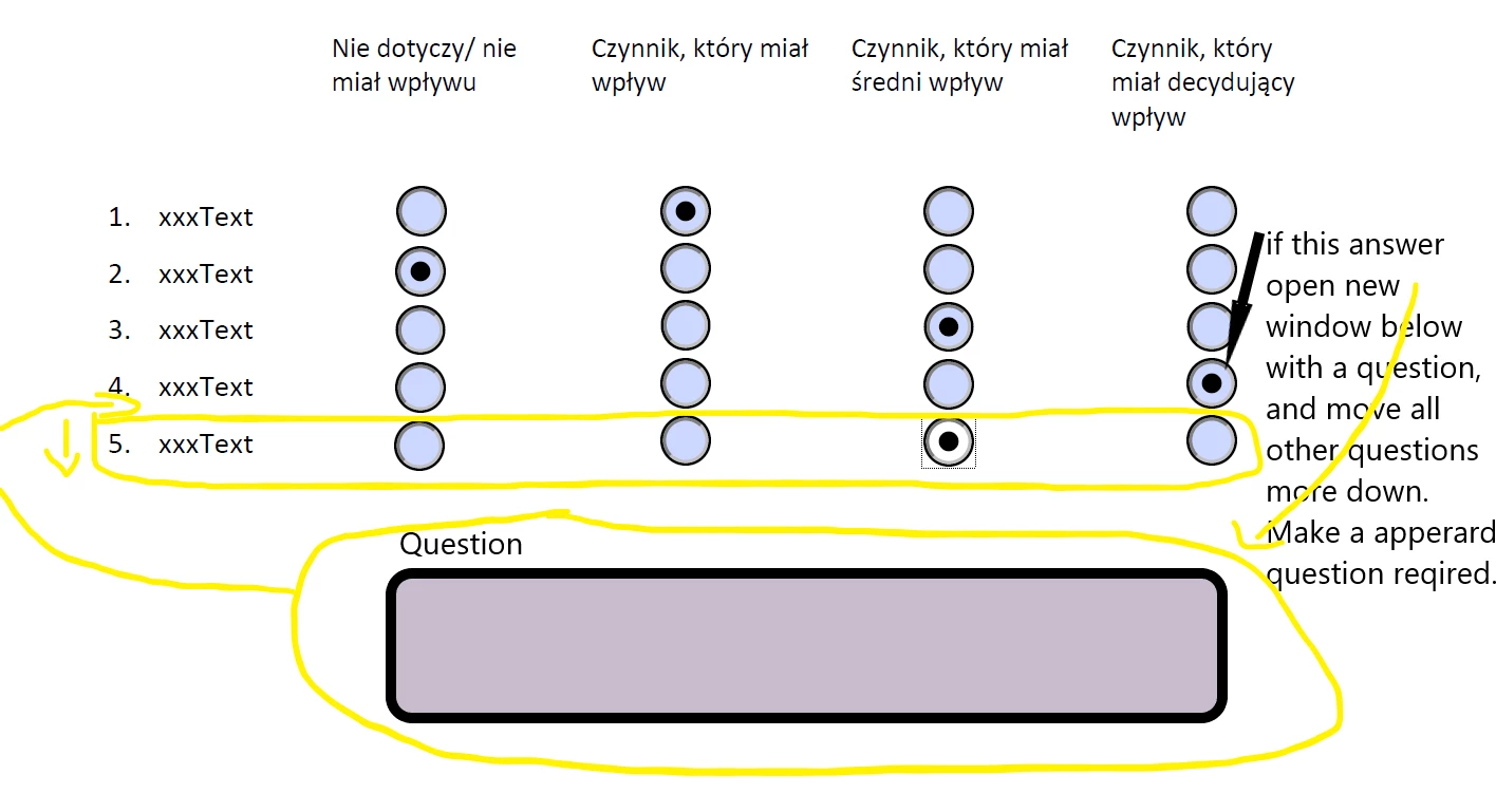

Hey,
is there anyone who could help me write the commend to my PDF form in JavaScript?
What I would like to achive is function "if".
If the responder give the answer "czynnik, który miał decydujący wpływ" then PDF plese open additional question below with required text answer.
To make myself 100% clear i attached screenshot with explenation.
Please, please, please help me. I would be very apprecieate for any tips.

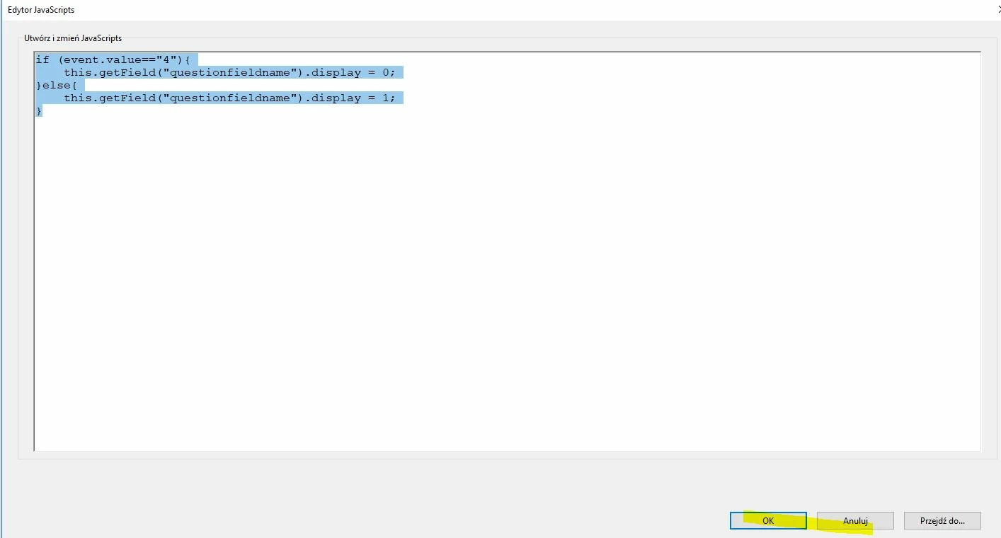

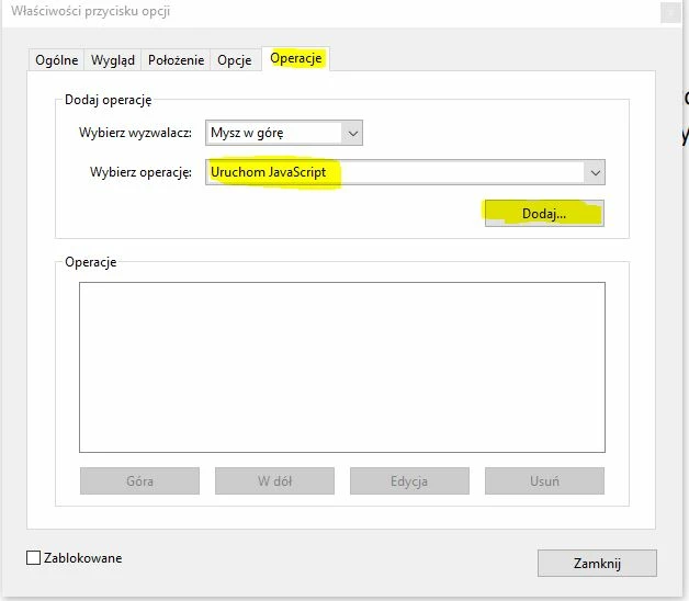

sylwiad4164059
Jan 24, 2020 11:50 AM UTC
Thank you, for your answer.
While i try to imput what you created for me nothing happened. So i am wondering if i did it right.
Went into button 4
And then i paste the code and nothing happened:(
