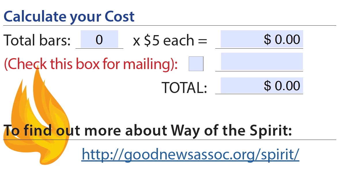

If/then script needed so a text field is automatically filled in if a specific checkbox is checked
I am making a simple fillable acrobat pdf form. I would like a text block to automatically be filled with a number (specifically, "$8.00") if and only if a neighboring check box is checked. I surely would appreciate any help. By the way, the name of the checkbox is MailingCheckbox and the name of the text field is MailingFee. Below is a screenshot of the specific area of the form. Thanks in advance!
try67
try67Correct answer
November 2, 2016
OK. Use this code as the custom calculation script of the text field, then:
event.value = (this.getField("MailingCheckbox").valueAsString=="Off") ? 0 : 8;

try67
November 2, 2016
If the box is not ticked, should the text box be enabled for user input, or should it be set as zero (or as blank) automatically?
November 2, 2016
Thank you, try67! Good question. I was thinking that if the checkbox was NOT checked, the text block would remain blank, but I guess it could be $ 0.00 to begin with and change to $ 8.00 if checked.
Sure appreciate your response!
Jim
try67
try67Community ExpertCorrect answer
November 2, 2016
