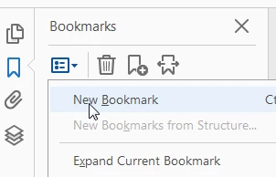

I will explain what I can about your question --
InDesign cannot do what you want, so you need to save your file as PDF. If you have created a bookmark in InDesign that you want to preserve, save it as PDF Interactive. (That is not a necessity because it is so easy to create bookmarks in Acrobat.)
Open the pdf in Acrobat (You need Acrobat, not Reader). Zoom in to the small text.
Then, in the Bookmarks panel, create a new bookmark (or use the one preserved from InDesign).
Right click on the bookmark and choose Set Destination.
That takes care of the zooming. You can test it by zooming out and then clicking on the bookmark. Click the icon to the left of the bookmark, not the bookmark label.
As far as rotation, although JavaScript has the setPageRotations( ) method, it won't work in Reader. Also, be aware that very little Javascript works on mobile devices. If it is important to take into consideration, you can instruct users to choose the View > Rotate View command or use the keyboard shortcut
Control Shift +
to rotate clockwise and
Control Shift -
to rotate counterclockwise.
