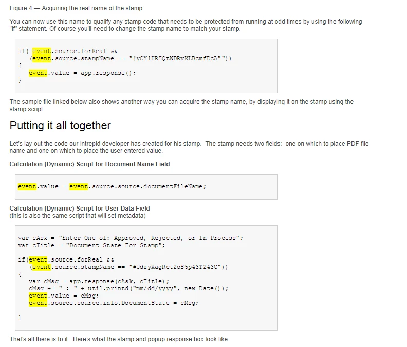

Hello Jeremy,
      To start, just as a helpful communication tip. It is a good idea to try and post code with proper formatting so we can follow it. This is especially important for large scripts.
First thing to do, remove the "event.value = app.response" line.
Just looking at the code there is one glaring issue. "event.value" refers to the value of the form field in which this calculation script is placed. Yet it's used for all the response boxes. For setting the other field values you need to use "this.getField().value"
Typically, if the response box is popping up when you show the stamps menu, then the response box code is unprotected. This is because the stamp script is executed every time the stamp menu item is exposed. However, you're script does protect the calls to app.response. So your description and the code you've posted don't match. There must be other code in the stamp file that is displaying the response box.
There are two ways to approach a fix.
1. Delete all code in the stamp file and start over with one response box in one field calculation script. Once you get that working, then try another, and remember, all calculation scripts must be protected with the first if statement in your code above. i.e. the if that use "event.source.forReal"
2.  This is the really easy solution. Joel Garcia created an incredible tool for automatically creating dynamic stamps, and its free!!! Down load it from here:
http://practicalpdf.com/the-practicalpdf-dynamic-stamp-dialog-creator-for-adobe-acrobat-dc/
Thom Parker - Software Developer at PDFScriptingUse the Acrobat JavaScript Reference early and often
