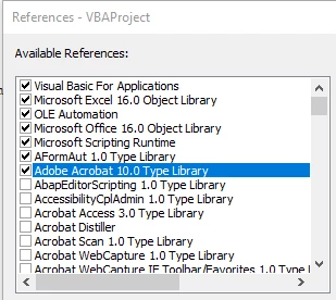

Here are the references:
I'm using Adobe Acrobat Standard DC, 2015 Release (Classic) | Version 2015.006.30434. Do I need the Professional version for this code to work?

Public Sub ListPDF_Fields()
    Dim AcroExchAVDoc As CAcroAVDoc
    Dim AcroExchApp As CAcroApp
    Dim AFORMAUT As AFORMAUTLib.AFormApp
    Dim FormField As AFORMAUTLib.Field
    Dim FormFields As AFORMAUTLib.Fields
    Dim bOK As Boolean
    Dim sFields As String
    Dim sTypes As String
    Dim sFieldName As String, PDFPath As String
    ' For this procedure to work, computer must have a full version
    ' of Adobe Acrobat installed. Also, a reference to the following
    ' Type Libraries must be made:
    '     AFormAut 1.0
    '     Adobe Acrobat 7.0 (or newer)
    On Error GoTo ErrorHandler
    PDFPath = Range("B" & ActiveCell.Row)
    Set AcroExchApp = CreateObject("AcroExch.App")
    Set AcroExchAVDoc = CreateObject("AcroExch.AVDoc")
    bOK = AcroExchAVDoc.Open(PDFPath, "")    '**************File open is successful
    AcroExchAVDoc.BringToFront
    AcroExchApp.Hide
    If (bOK) Then
        Set AFORMAUT = CreateObject("AFormAut.App")
        Set FormFields = AFORMAUT.Fields
        For Each FormField In FormFields '***************No FormField objects exist for processing!
            With FormField
                sFieldName = .Name
                If .IsTerminal Then
                    If sFields = "" Then
                        sFields = .Name
                        sTypes = .Type
                    Else
                        sFields = sFields + "," + .Name
                        sTypes = sTypes + "," + .Type
                    End If
                End If
            End With
        Next FormField
        AcroExchAVDoc.Close True
    End If
    Debug.Print sFields
    Debug.Print sTypes
    Set AcroExchAVDoc = Nothing
    Set AcroExchApp = Nothing
    Set AFORMAUT = Nothing
    Set FormField = Nothing
    Exit Sub
ErrorHandler:
    MsgBox "FieldList Error: " + Str(Err.Number) + " " + Err.Description + " " + Err.Source
End Sub
