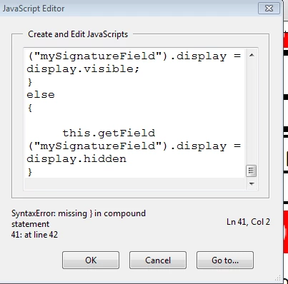

CiaranMHRAuthor
Apr 24, 2019 1:56 PM UTC
Hi Malcolm
I followed the instructions on the link. I created a hidden field on the form and added the below script but its bringing up an error message?
var emptyFields = [];
for (var i=0; i<this.numFields; i++) {
     var f= this.getField(this.getNthFieldName(i));
     if (f.type!="button" && f.required ) {
          if ((f.type=="text" && f.valueAsString=="") || (f.type=="checkbox" && f.value=="Off")) emptyFields.push(f.name);
if (emptyFields.length>0) {
     app.alert("Error! You must fill in the following fields:\n" + emptyFields.join("\n"));
f.valueAsString==""
0=="";
var aFields = ["Start Date", "Name", "Status", "Job Title","Person Type","HR Manager","Manager","Working Hours","start","Finish","Pro Day","Pro Mont","Note Day","Note Mont","Evac Site","Roster","Softworks Dept","Currency","Salary","Sal Basis","Sal Year","Per","Per F","Company Car","Car Allowance","Fuel Card","Fuel Allowance","PlanType","LocalBonus","Sub Plan","Annual Target","Target Amount","Charged Segment","Healthcare","Local Healthcare","Life Insurance","Overtime","Employee","Employer","Organisation","BU Overide","Department Headcount","Location","Payroll1","Assign Category","Job Code","Apprenticeship","Location120","Account","Cost Centre","Product Line","Interco","Future","dropdown1","dropdown2","dropdown3","Safety","TTMS Module","Non-Majority","Badge/Fob","Internet","Laptop",];

Bernd Alheit
Apr 24, 2019 2:04 PM UTC
add a } at the end.
try67
Apr 24, 2019 2:14 PM UTC
There are other issues with the code. Namely, it's an amalgam of two ways of doing it, one that checks all requires fields in the file and one that checks specific fields, defined in a list. It doesn't make sense to use both.
