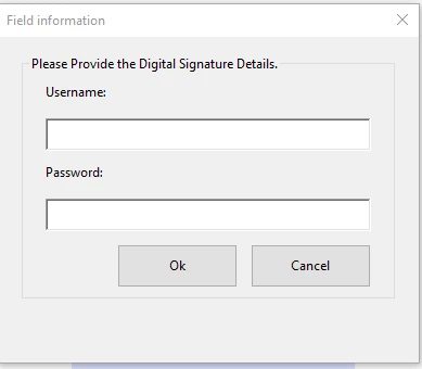

 I have question regarding Digitial Signature, I create a custom script for the Digital Siganure and it's working fine, but I'm passing the null user name and Passoword/ wrong password it open
the above page, is there any way we can hide this or disable it.
I'm using the below box to pass the user name and passoword.

Aug 14, 2020 8:02 AM UTC
Hello Thanks for your help.
if(this.getField().value.length == 0)
// get the logged in user
var passwordcorrect=0;
while(passwordcorrect<=0)
cRtn = app.response ({ cQuestion:"Enter your Username:", cTitle:"Your Digital Signature", bPassword:false, cDefault: newusername, cLabel:"username"});
newusername = cRtn
cRtn1 = app.response ({ cQuestion:"Enter your password for Username:", cTitle:"Your Digital Signature Password", bPassword:true, cDefault: "", cLabel:"Password"});
passforfield = cRtn1
if(cRtn1.length && cRtn.length)
var ppklite = security.getHandler("Adobe.PPKLite");
// find the certificate and path
var Certicatename=cRtn.concat(".pfx")
var pathname="/C/Adobe/DigitalID/";
var fullpathname=pathname.concat(Certicatename);
try
ppklite.login(cRtn1, fullpathname);
passwordcorrect=1;
// Set focus on a signature field
var f = this.getField(clickedFieldname);
// Sign it and log out. Change as appropriate
f.signatureSign(ppklite,{password:cRtn1,location: "NA",
reason: "I am signing for this step",
contactInfo: "",
appearance: ""});
// Required if the password is available
ppklite.logout();
it's the half part of my script, my script is working.. I have tried as you suggested but that is not working

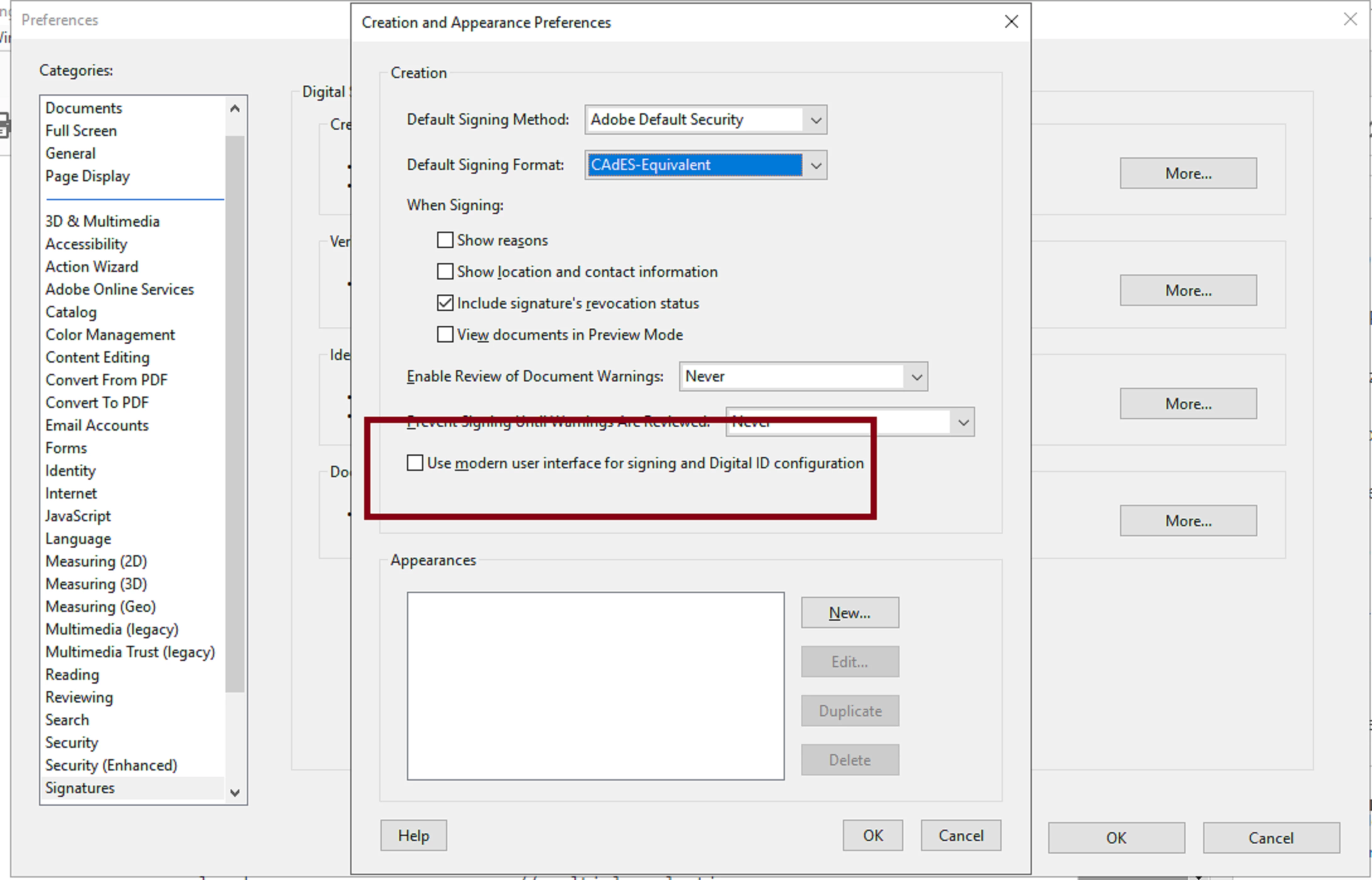

Aug 16, 2020 10:28 PM UTC
Hey mlz123456!
Sorry for taking this long to reply back but I had to read a lot.
I've consulted the  "Acrobat JavaScript Scripting Reference", the Acrobat JavaScript API Reference Guide", and also with  the Acrobat Enterprise Toolkit - Preferences Reference", and the "Digital Signatures User Guide for the Acrobat Family of Products: A guide for IT and enterprise users".
Your main question  have  a yes and no answer,  depending on which context we're referring to.
  • Is it possible to Hide/Disable Default Signature Box?
       No. It is not possible to hide and it is not possible to disable it.
What is possible though, is that you can switch the appearance of that dialogue box  via registry keys (or Plist if on macOS), or you can do it manually by going to EDIT--->> PREFEERNCES--->>SIGNATURES--->>> "Creation & Appearacnce" -->> click on "More".  In the next dialogue box un-tick the box "Use modern interface for signing and Digital ID configuration".
See slide:
The problem with that is,  that this setting is not locakble, meaning that, users can toggle this preference locally in their desktop. And it won't be retained with  that document unless you figure out how to embedd the setting with the  PDF, save the file with reader enabled rigths and restrict (encrypt) with password to prevent editing.
In your case, if this is at work, one available avenue is to disable that preference setting via Group Policy and the Acrobat t Cutomization Wizard (during installation time). This will prevent all users from messing around with it.
The registry keys that need to be disabled are discussed here: Enterprise Toolkit | Windows Registry Reference - Signing: Appearances
See quote below:
  • The newer UI streamlines the user interface. All values also disable the UI option to change the preference. Note that for products released after June 2016, disabling a user's ability to create a self-signed digital ID requires setting both "bSelfSignCertGen" and "bEnableCEFBasedUI" to 0.
  • Possible values include:
    0: Disable the modern UI and shows the legacy UI.
    1: Enable the Modern UI.
From further reading, it is possible to avoid the annoying Sign Document dialogue if you add to your current script another small script to  create the signature field for the user rather than having the user right-click and sign on a pre-existing signature field.
