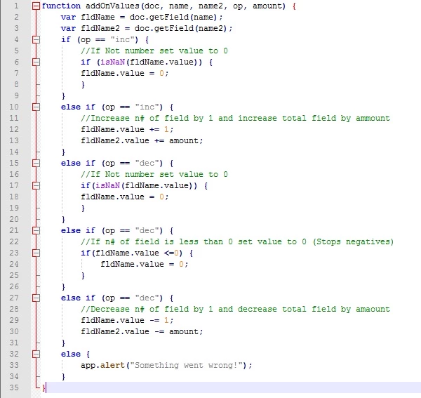

I checked the console, at first it said that inc was not defined because I had forgotten the " " around it, after that I ran it again and still nothing happened, so I checked the console again and it was clear of any error messages.
Edit: I've also checked that all the field names are correct aswell.
Edit2: I changed the else if statements to simply if statements and it works, however it also runs the else statement aswell.
I general, to debug a problem like this, I would add the following line at the top of the function:
app.alert("addOnValues: " + name + " " + name2 + " " + op + " " + amount);
This will print all the parameters passed into the function, and will show you that the function actually got called. Alternatively, you can use the JavaScript debugger and set a breakpoint on the first line of this function, and then single step through the code.
However, in this specific case, I can tell you what's wrong (the first time I looked at your code, I only had my cell phone, now that I am working on the computer, it's easier to see what's going on): The if/else if construct you are using has the same conditions multiple times:
if (op == "inc") {
else if (op == "inc") {
In an if/else if/else construct, only the first condition that matches will be executed. After that, the interpreter jumps to the end of the construct, and executes the next command. You will need to create if statements on two levels:
if (op == "inc") {
    if (isNaN(fldName.value)) {
   else {
else if (op == "dec") {
  else {
else {
You can simplify this a bit more because you know that the action for the "isNaN" case is always the same, so you could use this:
else {
Again, this is just normal JavaScript and has nothing to do with Acrobat's JavaScript implementation. You may want to read up on the core JavaScript syntax.

May 11, 2016 10:25 AM UTC
Thank you for you answer Karl, I've had a go at writing the alternative function but I think I've gone wrong somewhere,
Here is what I have written
And here is where I have called the function
I added an extra parameter (name2) for the second field that I call which is the total sum of what's been added/removed
It runs without an error but nothing happens not even the app.alert and I can't figure out why.
I feel it may be something simple or the simple fact I've written it completely wrong I don't know.
Karl Heinz  Kremer
May 11, 2016 10:35 AM UTC
From what context are you calling the function? Is it a mouse up handler on your buttons?
