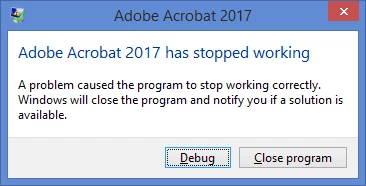

    Get the following error
    Debugging I see
    Unhandled exception at 0x5F696E3D (Acrobat.dll) in Acrobat.exe: 0xC0000005: Access violation writing location 0x00000014. occurred
