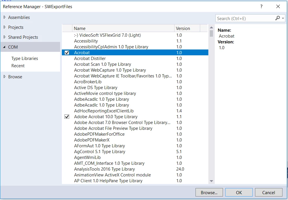

I have Adobe Acrobat Standard DC installed core version 18.2304. I'm using Visual Studio 2017 and using Visual Basic. I'm trying to create a code to mark a pdf drawing as a draft. I'm starting from the example on one of Adobe's iac developers's guide example thinking that would be a good place to start. I tried out the code that starts on page 23. It didn't work, and I've narrowed the problem to the JSObject. I can use methods from pdDoc to get the correct filename for the PDF, so I think all is working up to that point. The jso object also isn't nothing, so it enders the if statement, but the jso object doesn't have any of the methods used by the pdf example available, so it throws me an error when I try annot = jso.AddAnnot. I have the below references added to the project. Anyone have any idea what the issue might be? Thanks in advance for any help!
