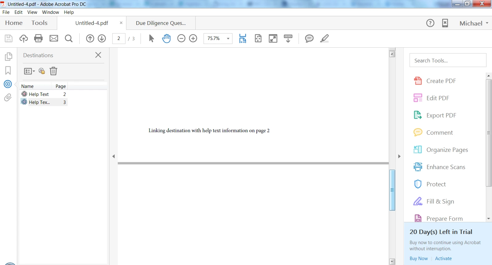

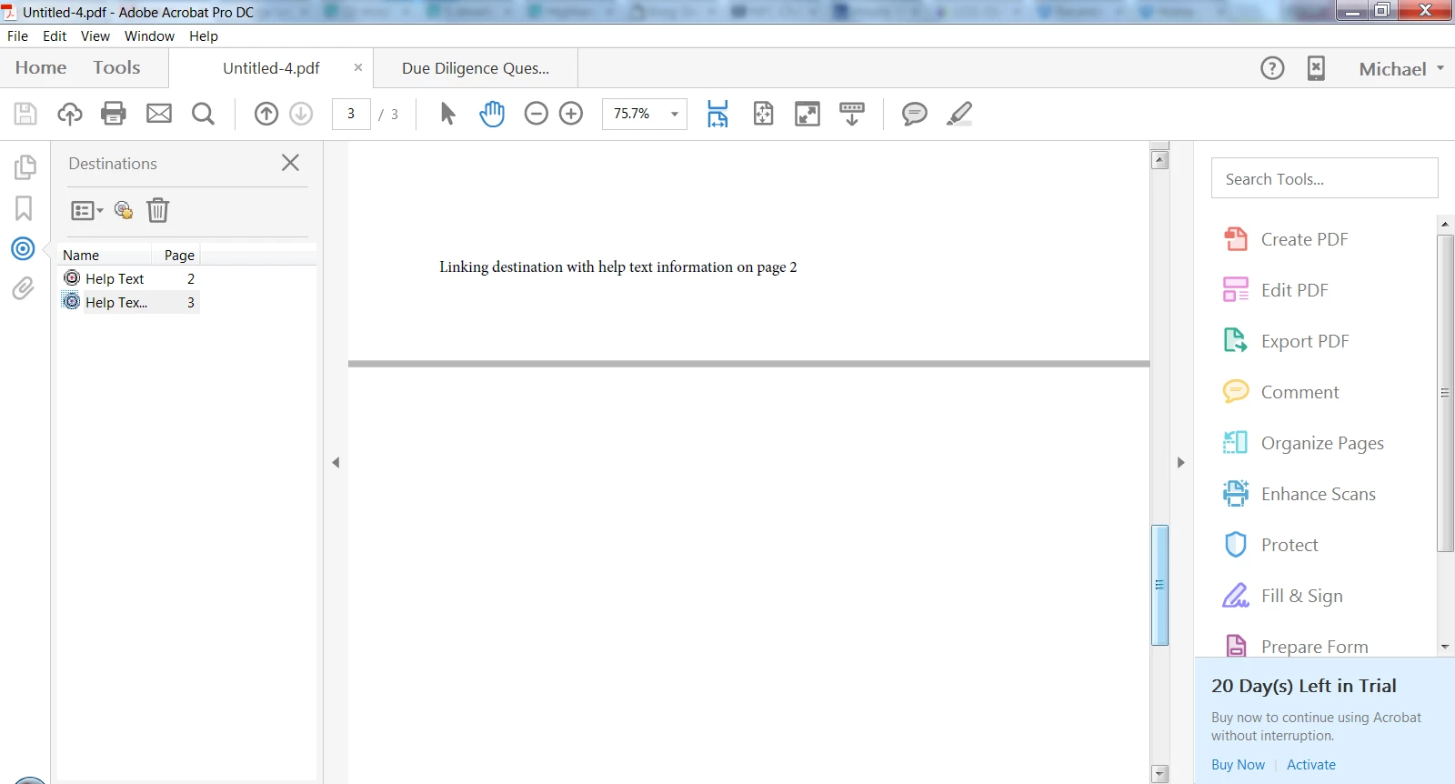

Thanks for the quick reply.  It appears that the issue is because the item I'm tying to link to is close to the beginning of a new page.  Below is an example of my issue.  Please don't judge me too much on how terrible the pdf looks!  The first button on page 1 works and pushes you down to the top of page two.  However the second link on the first page moves you to the third page although I tried to set the destination on page 2, it still puts it on page 3.
Dropbox - Untitled-4.pdf
In the screenshot below you see that I'm on page two. I'm trying to set the destination to this text.  However when I line up that text to the top of the view, it claims that I'm on page 3 and then sets my destination to page three, not page two where my text is.  Any thoughts?

This is correct. It displays the destination on the second page.
