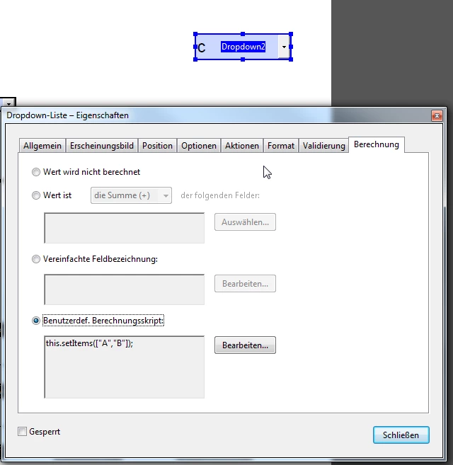

Thank you for the answer! I've seen similar solutions before but i just can not get js to set Items in a dropdown.
Here i tried to simply add the values A and B to this dropdown but it won't work. What am i missing?

October 12, 2017
You're missing a reference to the field, using the getField method. The "this" keyword usually refers to the document.
See my example above.
