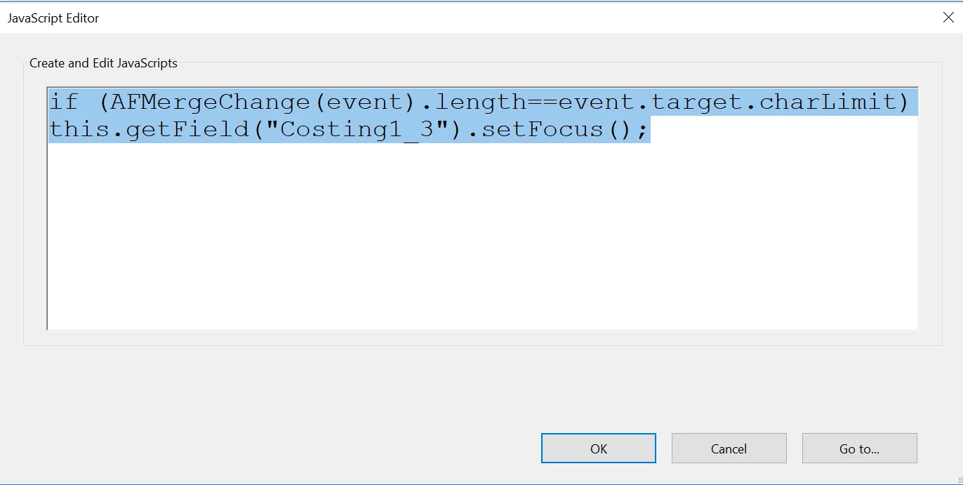

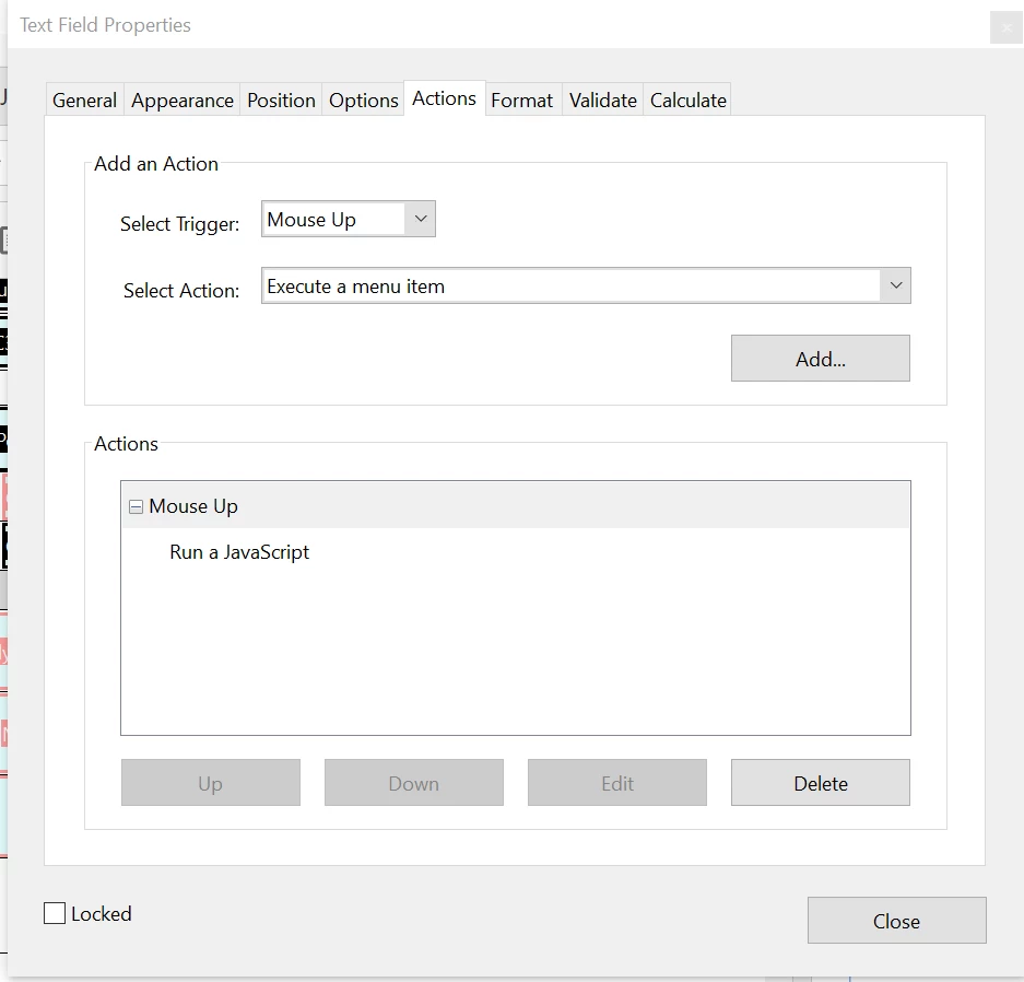

NaDiA-rAXu4u
Nov 3, 2018 11:35 PM UTC
On the field self:
try67
Nov 3, 2018 11:37 PM UTC
Read the discussion in that thread more carefully. It needs to be the field's custom Keystroke script.
NaDiA-rAXu4u
Nov 3, 2018 11:30 PM UTC
I am very new to the javascript.....myne does not work. What am I doing wrong?
try67
Nov 3, 2018 11:32 PM UTC
Seems fine. What happens when you try to use it? Also, where did you place the code?
