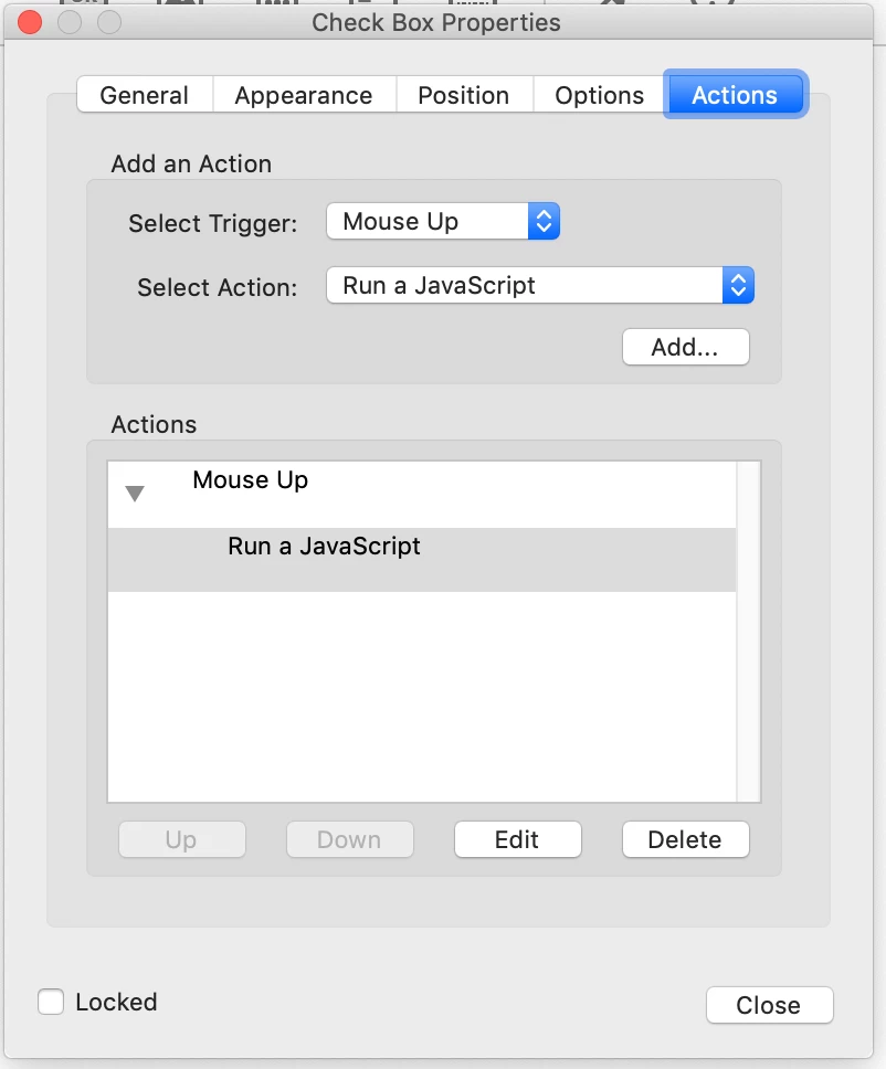

Hello! I'm hoping some one can help me out there.  I'm using Acrobat DC.  I have a form that has a small area that I can't seem to figure out how to make it do what I want, if it's even possible.  I would like a set of radio buttons to only appear if another check box is selected AND for them to dissapear when the check box is deselected.  I can make the first part happen by adding a "show/hide" action but this only works one time.  If the check box is deselected the radio buttons stay visible.  If this has to been accomplished by using a javascript, please site an example as I am a complete newbie at that.  Thanks!

You need to employ a javascript action from the checkbox.
Open the checkbox properties --->>> go to the Actions tab--->>> "Mouse-up" action javascript,  and You copy the script below :
