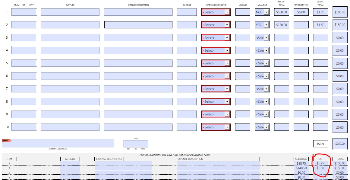

I'm working on an expense form where I am having some trouble with figuring out how to code my form to correspond to the excel formulas. I want the GST in the 'Accounting Area' to calculate based on
1. If there is mileage entered above
2. if 'yes' selected in the meal/ent dropdown I want the GST to be 1/2 the actual GST amount.
I hope this makes sense?

I have fixed it but I am still having trouble, the GST box doesn't show anything at this point. I don't know what I am doing wrong, this seems like it should work but it just wont and I'm so frustrated because I have literally spent days doing trial and error on this and getting nowhere. Am I missing something here? Does this make sense? Would anyone be willing to look at a sample? Its a calculation based on whether mileage or a meal is selected in the top portion, the bottom portion is the accounting entry part.
var total = this.getField("TOTAL.0").value;
var subtotal = this.getField("SUBTOTAL0").value;
var mileage = this.getField("MILEAGE.0").value;
var meals = this.getField("MEALS0").value;
var gst = this.getField("GST/HST.0").value;
if( mileage > 1) event.value = ((mileage*0.51) /1.05) - total;
if( mileage < 1) event.value = "";
else if( meals == "YES" ) event.value = total/.5;
else if( meals == "NO" ) event.value = gst;
else event.value = gst;

I have no idea how to do that, I don't know anything about JavaScript or accounting, so I'm learning as I go here. In my original example I have both items on the same line, so the GST is conditional based on if a number is put in mileage OR if there is an amount put in the receipt total and it is defined as a meal or not. In my mind this looks like the right order, can you give me an example of how its wrong?
I appreciate the help, but I have no clue how to go about fixing it hence this forum post.

Following this the best I can, I have come up with the following, but it doesnt work. Can anyone help me with where I have gone wrong?
var meals = this.getField("MEALS/ENT.0").value;
if( meals = "yes" ) event.value = gst / 0.50;
else if( mileage > 1) event.value = (total / 1.05)*0.05;
Thanks again.

Pretty good... I see one mistake, though. The comparison operator in JS is "==", so change this line:
if( meals = "yes" )
To:
if( meals == "yes" )
