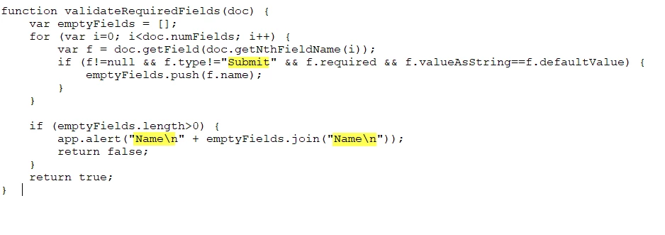

laulzAuthor
Jul 17, 2018 11:33 AM UTC
It doesn't have to highlight, it can just be a red box or a pop-up or basically just something that indicates that values are missing.
Unfortunately, that didn't work. Nothing happens if I leave the fields blank or if I fill them in (at which point I should be receiving a mail I guess).
I changed the email address, changed the name of the button and changed the name of the field. First I tried by using the names of 2 different fields and then just the one "Name" field.
try67
Jul 17, 2018 12:01 PM UTC
Don't change anything in the code I provided, especially if you don't know what you're doing...
