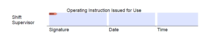

I was wondering if you would be able to help me out. I wanted to automatically insert the date and the time once the signature field has been filled [image shown below]. How can I do that? What script should I use? Thanks
