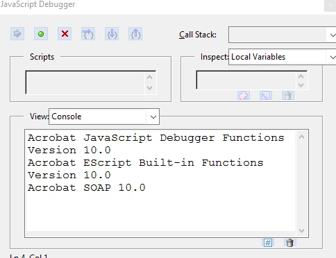

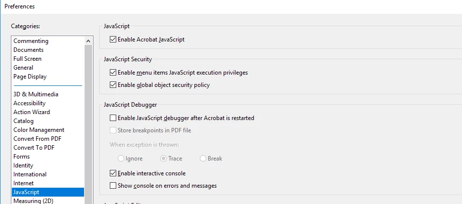

I have already enabled it. Even after enabling from preferences run button is still disabled. I don't know what else i need to do. One more thing i noticed is AcroPDDoc dll does not contain 'saveAs' method. Any help?

Enter the code in the debugger and press ctrl-a and ctrl-enter

Don't use the run button.

Javascript run is disabled

Enable it in the preferences.

How can i do that? when i try to run some js code JS run option is disabled

Start the debugger with ctrl-j and use the saveAs method.

What happens when you try it with the JavaScript debugger in Acrobat?
