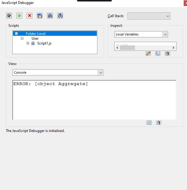

Hello community,
I have been trying to write a JavaScript extension which makes a 'GET' request to a server on pressing of a sub-menu item in Adobe Acrobat professional. After writing the script after following from an online resource(https://gist.github.com/randycasburn/802f278c3cfef0873dd086c34bbb9fee), I tried executing the folder level script but it gave an 'object aggregate' error in console. I tried looking for it online but could not found anything helpful. I think the issue is with the request which is not able to fetch data. Below is the script for the same. Any help regarding this would be greatly appreciated.
Thanks.

Below is the screenshot of the error:

May 29, 2020 12:41 PM UTC
Ah, I understand. There is no error. This is not a JavaScript failure or error message: it is YOUR message, as created in the line you noted: var error = e == undefined? 'No HTTP errors' : "ERROR: " + e;
because the value of e, which is an object, if you force it into a string context is "[object Aggregate]".
So I hope from the other replies you now know why this happens, and how you might make the message more useful to you in solving failure of Net.HTTP.request.

try67
May 29, 2020 12:26 PM UTC
Change:
"ERROR: " + e
To:
"ERROR: " + e.toString()

nishant13Author
May 29, 2020 2:31 PM UTC
Thanks! It worked. But now it is showing "error:-8","text: There was a problem connecting to the server ", "type: Network Error". Any clue as to why is this error?
May 29, 2020 12:10 PM UTC
Actually, I think the problem is that "e" is not a string, and cannot be made one.
oException An exception object if the method was not successful. The
exception object has the following properties:
error — the HTTP status code that was returned.
msg — An error message associated with the failure.
