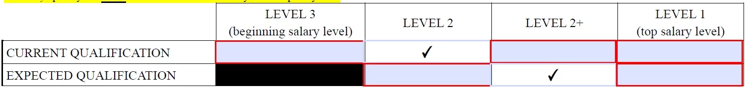

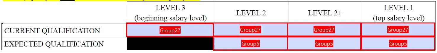

I just did a quick check to see if there weren't in the same group and I do have them in the same group.  So, I don't think that is it.  I've attached the editor view photo for you to see what I am trying to express (albeit somewhat poorly, lol).
So, as you can see, they are in the same group and I have them all as required fields.  So when I go to try and fill out the application form it results in the following:
For some reason it is still showing that the other radio buttons are required.
I hope this clears up what I was trying to say.  Thank you again for your help.
try67
try67Community ExpertCorrect answer
January 28, 2018
The red border only means the field is set as required. It doesn't change when you fill it in (or not).
The validation of the required fields only occurs when you actually submit the file.
If you want the red border to appear/disappear based on whether or not the field has a value you would need to use a custom script to do it.
