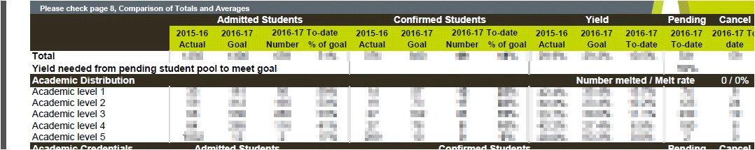

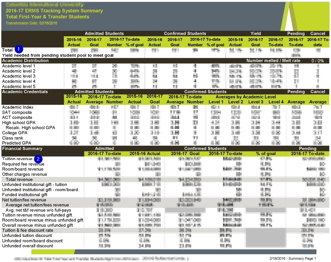

One of my users' documents all look terrible when printed to PDF. The text is not sharp and some lines (indicated 1 and 2 on the screenshot) have part of the line cut off. This is Excel 2010, using Acrobat X.
I have changed the print settings to high quality and I have ensured there is no page scaling going on, either from Excel or in the PDF printer settings.
All the numbers and client names in the image are pixelated because they contain proprietary information. That is intentional and unrelated to the issue at hand.
Thank you!

Thanks everyone. Yes, this is the on-screen PDF.
Excel is not the culprit. Printing to a regular printer from Excel works fine. Looking at the preview in Print Preview, this is also fine.
We tried PDFMaker but the sheet in question uses macros and scripting, and with PDFMaker the buttons and controls from the spreadsheet are on the printout, messing with the formatting.
This is Acrobat 10.1.16.13. I just updated it to the latest version. Same issue. This is happening to all documents by one user created and printed from Excel 2013.

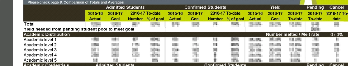

Here's a side by side sample of the same page from two separate machines.
Bad:
Good:
