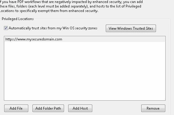

I have tried to add an https host but that does not appear to be working as I still get the warning.  Is there something else I might be missing from this end
Thanks again..
