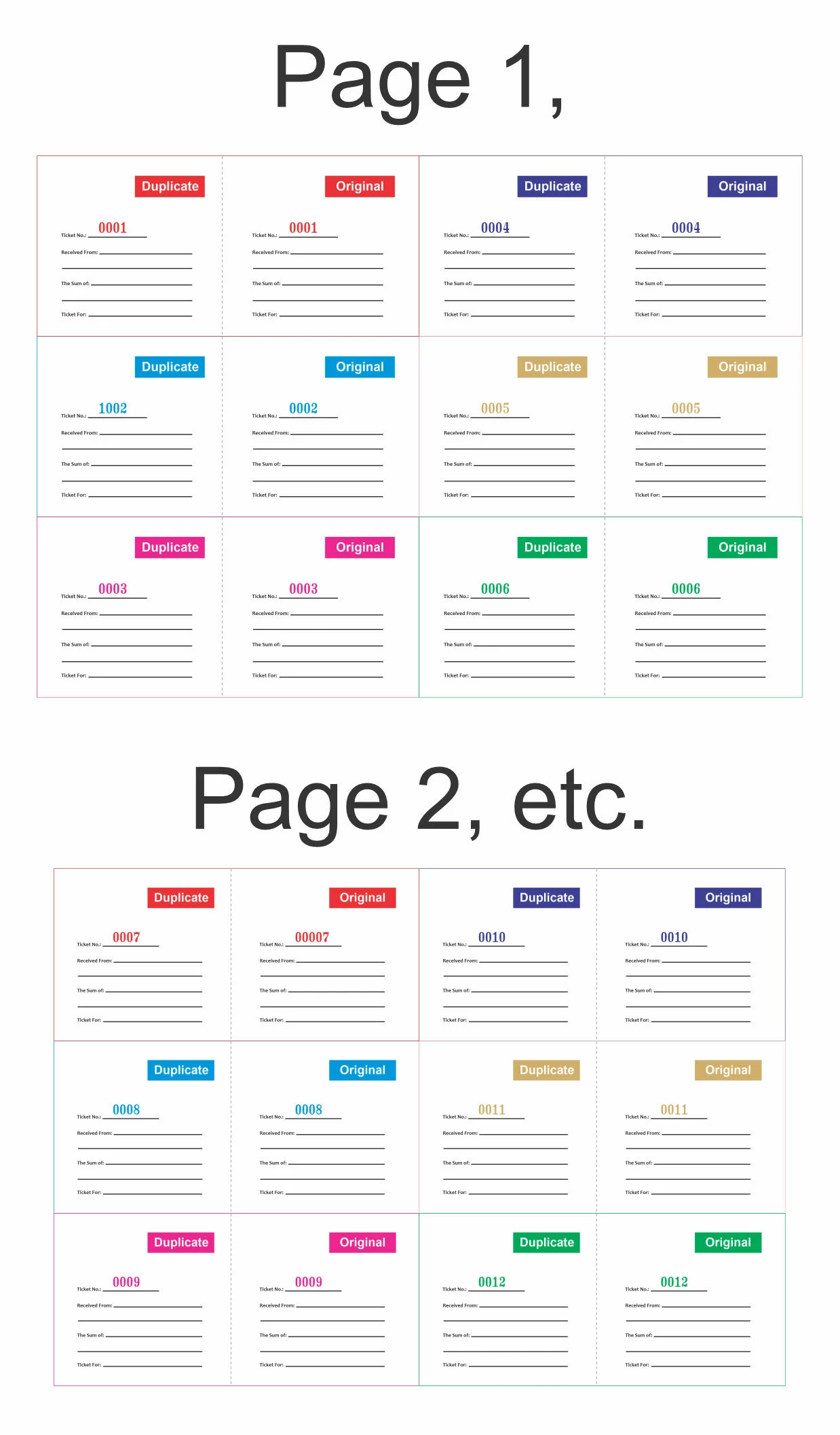

Please I need help to generate new serial numbers on a form during each print
Please and please i need help getting my following attached adobe form on my PC to generate new sequential serial numbers on the specified "Ticket Number" field on the form during each print. I print lots of copies of this template, during the production, i want the form to be able to generate serial numbers on the specific field just like the illustration attached. say i send 1,000 copies of the form to print, the numbers should be generated accordingly till the last copy.
Please i will appreciate any support to this request. Thanks

Doing that requires using a script, and you can't use the Copies field in the Print dialog because that only prints identical copies of the file, so each print needs to be in a separate command.
May 8, 2020 3:27 PM UTC
Ok, thank you try67,
are you saying it can only work like the following?
try67
May 8, 2020 4:41 PM UTC
It can work either way.
