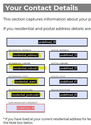

I'm trying to set up a form so that four text fields will populate with data from a previously user entered field (separate text in each text field) at the same time.
Below is a screenshot of the fields that I am looking to populate when "Sole-Trader" is selected from the "employment_type1" dropdown list:
When the dropdown list is set to "Sole-Trader", the data for fields "undefined_68, 70, 72 & 74" is to come from the following fields, which have been completed earlier in the document.

Thanks for the response and yes, if the user initially selects "Sole-Trader" from the dropdown menu, I would like the "undefined_66" field to be automatically populated with the previously entered data in the "residential_address_1" field.
If however, the user changes their mind and replaces "Sole-Trader" with another option, e.g. "PAYG", they need to be able to manually enter the details of their employer's address in the "undefined_66, 68, 70, 72 & 74" fields.
Any suggestions on what this script would look like?
