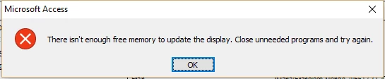

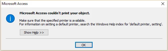

Running Win 10 Pro and I have numerous reports that I have created in an Access 2010 database and whenever I try to print a report to Acrobat XI I get an out of memory error.  Specifically:
"Microsoft Access couldn't print your object."  (hit OK), then next dialog box:
"There isn't enough free memory to update the display.  Close unneeded programs and try again."
I can print to Acrobat from any other application (even the other Office applications) but only have this issue when printing from a report generated in Access.  I can also create a PDF by printing to a generic PDF creator, but not when I print to the Adobe Acrobat printer.
Anybody have any ideas?  Thank you.

Thank you for the reply.  I am using:
Win10 - 10.0.10586 Build 10586
Microsoft Office Professional Plus 2010 - 14.0.7166.5000 (32 bit)
Acrobat XI - 11.0.15
And here are the two error messages I get:
These errors only occur when printing to Acrobat.  If I use the generic, "Microsoft Print to PDF" it will successfully create the pdf.  If i create the pdf from Word, Exel or Outlook, Acrobat comes up fine.  It is only when creating a PDF in Acrobat from any report created in Microsoft Access.
