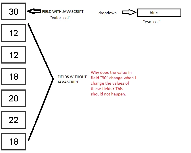

I created the following code for the field with the number 30:
var x = this.getField("valor_col").value;
var y = this.getField("esc_col").value; // another field (dropdown) that receives only color names (strings)
if (y == "red" ) {
event.value = x + 4
else if (y == "blue" ) {
event.value = x + 2
else if (y == "green" ) {
event.value = x - 2
else {
event.value = x + 1
The code is working correctly, the problem happens when I type any value in the other fields that do not yet have javascript code. For example, when I choose the blue color, my field should add 2 to the total, this actually happens, but when I type any value in any other field it adds 2 more to the value of the field that has the code I created (for example), and this should not to happen. Can you help me?
Thom Parker
Thom ParkerCorrect answer
January 17, 2018
Calculation scripts are called every time any field changes. You need to setup the calculation to work the same way every time. If the calculated value is incremented, then is x from the value of the field with the calculation on it? Otherwise, how could it increase?

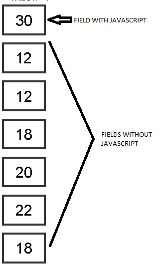

ericnandoj
January 17, 2018
Thank you for your quick answer,
But that's the problem, I do not want this increment to happen, it should not happen. In my understanding the other fields should not influence anything in the field that I set.
See if with this image my question is clearer:
