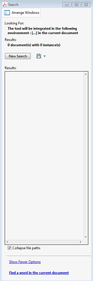

I specifically used with Search. As per your suggestion, I used ASTextFromEncoded(searchText, kUTF8); .
As you can see I have used UTF-8 encoding.
My searchText is = The tool will be integrated in the following environment : […]
And result is shown in below image:
As you can see, the text that Search plugin takes is correct but it does not "actually search".

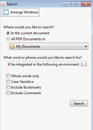

Now comes the interesting part:

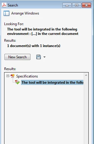

If I click on "New Search" button, then It takes the same search text as input to search and searches it successfully.
Here is the result:
This is very confusing. What are your thoughts on this?
