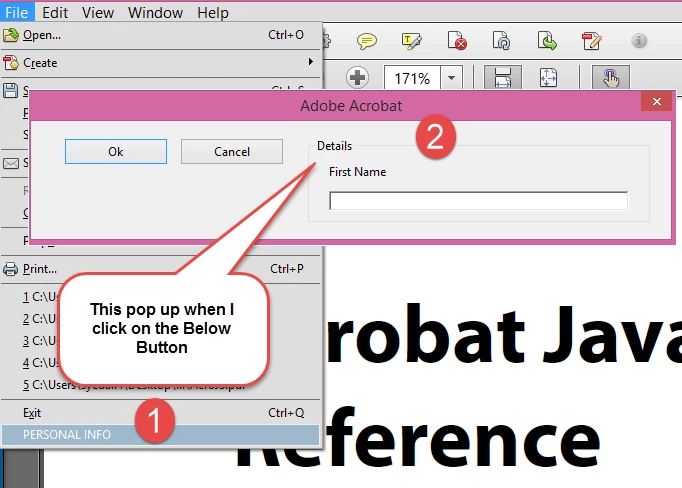

Below is my Folder Level Javascript which comes as a Pop up when I click on a Custom created button in a PDF reader..
I created a Test.js file and then pasted the below code in it. Then I copy pasted that file in the following path:  C:\Program Files (x86)\Adobe\Acrobat 11.0\Acrobat\JavaScripts
Now I want to know how to add either jQuery Code or the Normal Javascript in the below code. Please give an example.
Note: I am not using the Javascript Forms here. This is a folder ACROJS Javascript.
// Start of Code
app.addMenuItem({ cName: "PERSONAL INFO", cParent: "File", cExec: "helloWorld()" });
var helloWorld = app.trustedFunction(function () {
    app.beginPriv();
var dialog1 = {
description:
elements:
type: "cluster",
align_children: "align_left",
elements:
type: "static_text",
type: "edit_text",
alignment: "align_fill",
width: 300,
height: 20
alignment: "align_left",
type: "ok_cancel",
ok_name: "Ok",
cancel_name: "Cancel"
app.execDialog(dialog1);
app.endPriv();

try67
July 1, 2016
You can't use jQuery in Acrobat. Well, you can install it as a folder-level script, but it doesn't make any sense. The functions in it have no relevance in this environment. They were developed for web-based JS. Same goes for getElementbyid.
If you describe what you want to achieve we might be able to help you using the tools which ​are​ available and relevant.

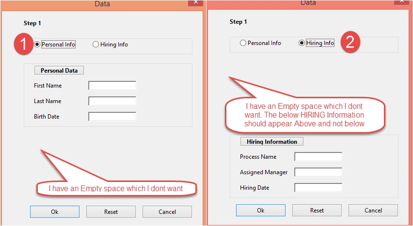

I have designed the below and I don't want the empty space to appear.
The empty space should be replaced by the Hiring Info.
Requirement:
In the screen 1 on Left the Empty space should not appear at all.
In the Screen 2 on the right the Empty space on the Top should not appear. It should be replaced by the Hiring Information Cluster Block.
I need a Grid layout in which I can place my Fields.
Please find below my complete code.
////My code
// This should be pasted in the folder : C:\Program Files (x86)\Adobe\Acrobat 11.0\Acrobat\JavaScripts
app.addMenuItem({ cName: "Hiring Info", cParent: "File", cExec: "helloWorld()" });
    app.beginPriv();
    var dialog2 =
        initialize: function (dialog) {
            dialog.visible({ "CLU2": false });
        rd01: function (dialog) {
            // First Option - Enable
            dialog.visible({ "CLU1": true });
        rd02: function (dialog) {
            dialog.visible({ "CLU1": false });
            dialog.visible({ "CLU2": true });
        // The Dialog Description
        description:
            elements:
                type: "view",
                align_children: "align_center",
                elements:
  bold: true,
  font: "dialog",
  char_width: 30,
  height: 20,
                    type: "cluster",
                    align_children: "align_row",
                    elements:
                        type: "view",
                        elements:
                            type: "radio",
                            item_id: "rd01",
                            group_id: "rado",
                        type: "view",
                        elements:
                            type: "radio",
                            item_id: "rd02",
                            group_id: "rado",
                // Add the Individual Types....
                //First
                    type: "cluster",
                    item_id: "CLU1",
                    elements:
  type: "button",
  item_id: "BUT1",
  bold: true,
  font: "dialog",
  width: "40",
  height: 20,
                        type: "view",
                        elements:
                            item_id: "1000",
                            width: 100
                            item_id: "1001",
                            type: "edit_text",
                            width: 100,
                            height: 20
                        type: "view",
                        elements:
                            item_id: "1002",
                            width: 100
                            type: "edit_text",
                            width: 100,
                            item_id: "1003",
                            height: 20
                        type: "view",
                        elements:
                            item_id: "1004",
                            width: 100
                            type: "edit_text",
                            width: 100,
                            item_id: "1005",
                            height: 20
                    type: "cluster",
                    item_id: "CLU2",
                    elements:
  type: "button",
  name: "Hiring Information",
  bold: true,
  item_id: "BUT2",
  font: "dialog",
  width: "40",
  height: 20,
                        type: "view",
                        elements:
                            item_id: "1008",
                            width: 100
                            type: "edit_text",
                            item_id: "1009",
                            width: 100,
                            height: 20
                        type: "view",
                        elements:
                            name: "Assigned Manager",
                            item_id: "1010",
                            width: 100
                            type: "edit_text",
                            item_id: "1011",
                            width: 100,
                            height: 20
                        type: "view",
                        elements:
                            item_id: "1012",
                            width: 100
                            type: "edit_text",
                            item_id: "1013",
                            width: 100,
                            height: 20
                    type: "ok_cancel_other",
                    ok_name: "Ok",
                    cancel_name: "Cancel",
  other_name: "Reset"
                type: "gap", //add a small vertical gap between
                height: 20 //..radio fields and buttons
        // End of Code for linking the Document for the Client....
    app.execDialog(dialog2);
