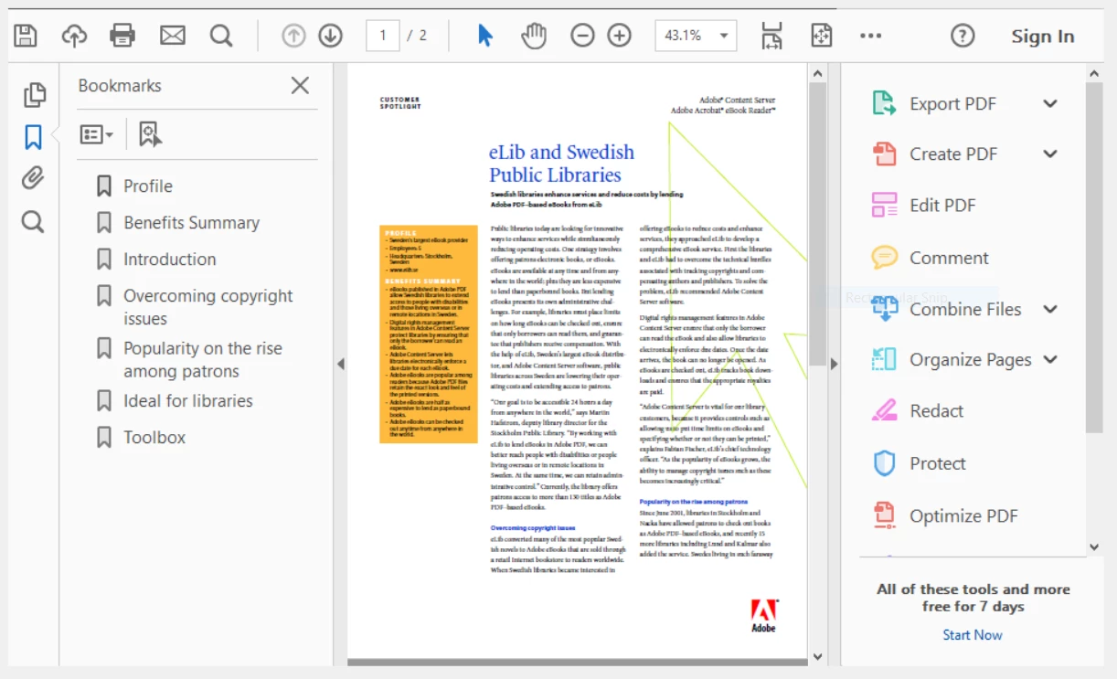

    As when I try to follow AcrobatActiveXVB sample in my application and open the document from the sample (https://www.adobe.com/epaper/pdfs/elib_swedish_libraries.pdf ), I get the following:
    And this is already strange since SetPageMode states that "none" is the default mode (Acrobat DC SDK Documentation).

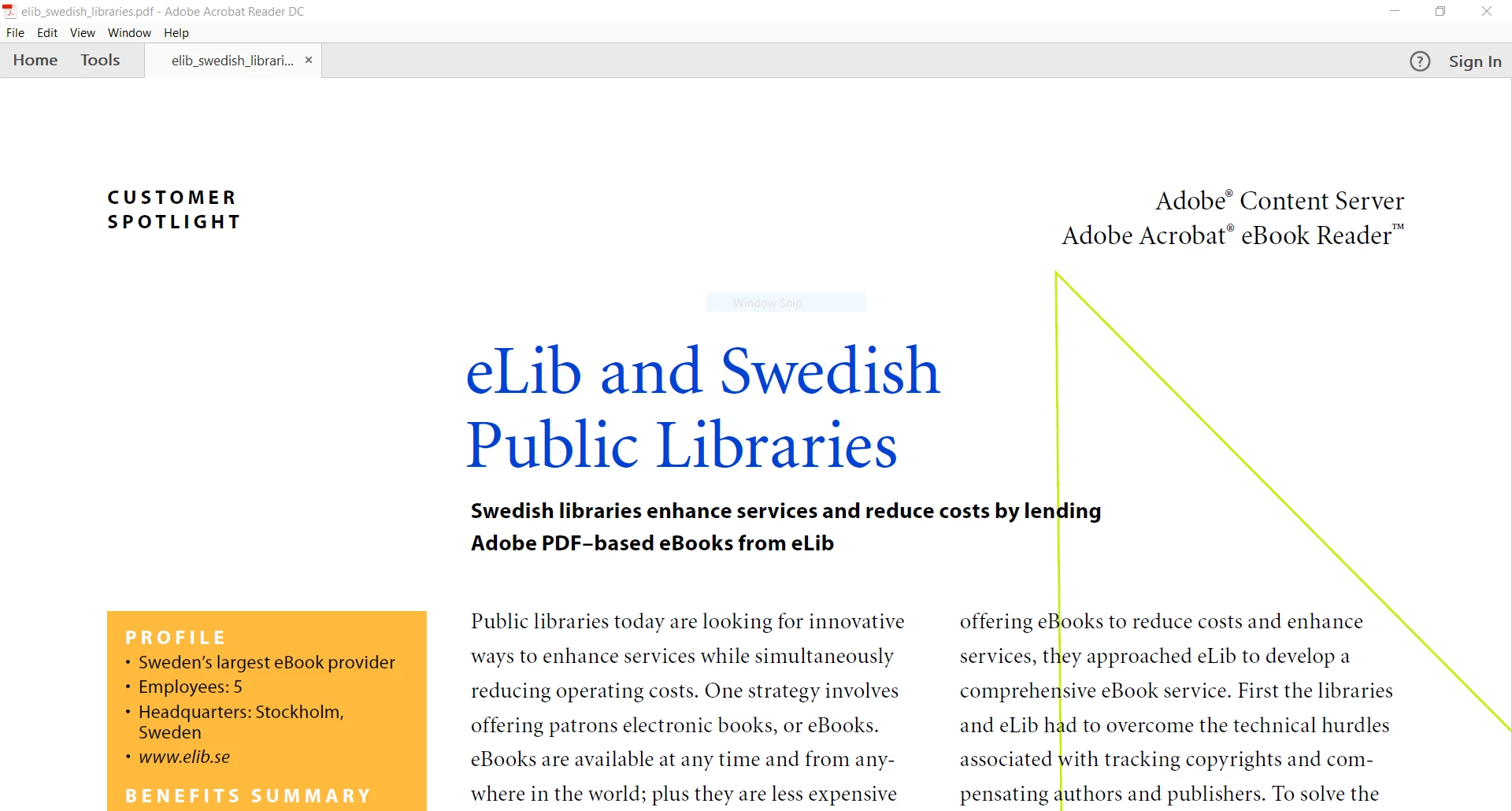

    But in order to get a nearly ideal look I still need to click on the arrows to hide UI elements, so I can get the following look:
    But there's still an arrow as UI element on the right side. Can I achieve something like this programmatically (ideally without that arrow on the right side)?
