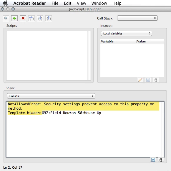

It Works fine in Acrobat Pro but it fails in Reader.
Error message from the JavaScript Console is:
NotAllowedError: Security settings prevent access to this property or method.
Template.hidden:697:Field Bouton 56:Mouse Up
(tested in Reader DC (Mac & Windows), Reader XI (Windows) and Reader 9 (Mac))

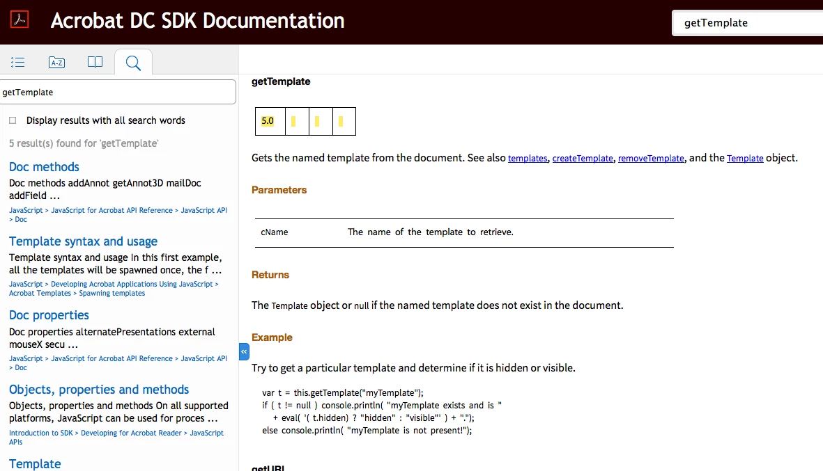

But… the JavaScript API reference shows getTemplate as available for Reader, beginning with version 5, there is not any restrictions in the quickbar.
As shown here : Acrobat DC SDK Documentation

Karl Heinz  Kremer
June 15, 2016
I don't see anything wrong with the online documentation. See here:
Acrobat DC SDK Documentation - Template.hidden
It clearly shows the "X" in the last column of the quick bar.
try67
June 15, 2016
The problem is not with getTemplate, but with the hidden property. It's read-only in Reader.
