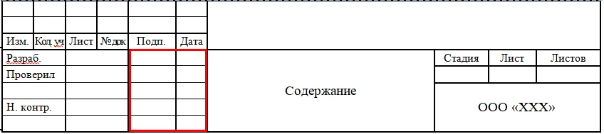

Is there an easy way to recreate a dialog box that looks exactly like in the picture. With buttons in those cells highlighted in red.
I tried the example from the API, it works, but the structure of the nested elements for my picture will be very complex.

HI,
It is a complex dialog that you want to create and I think through JavaScript it will be very complicated, would you consider doing what you need through a plug-in as that offers better (IMO) control of how you create dialogs, If you are limited to JavaScript then it will be complicated.
There is a sample in the SDK called wxPlugin, which gives an idea of how it works ( note: it has not been updated in a while) there may be a better solution.
try67
September 15, 2021
A dialog is not suitable for this kind of complex layout.
