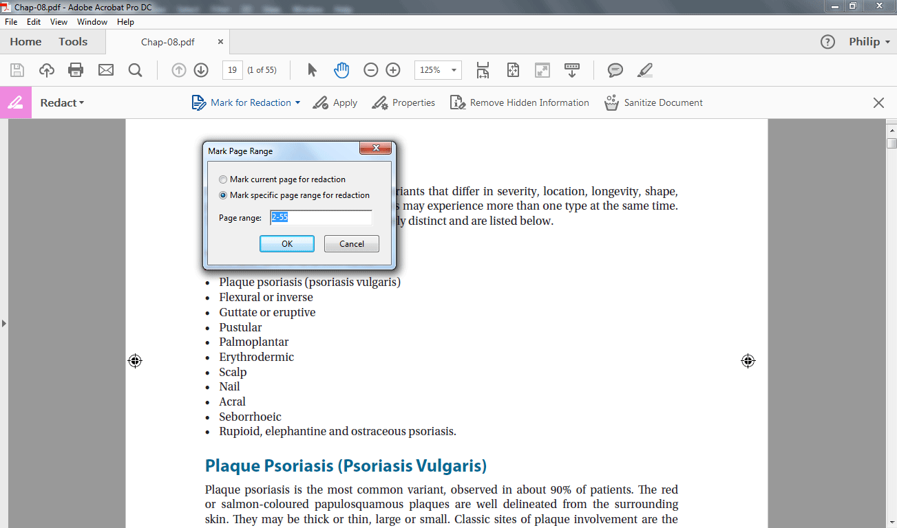

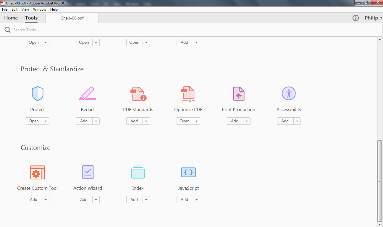

Why don't try to redact your document using it in Acrobat Pro DC without using script.
You can redact in accordance to your desire pages. See the images what i am doing for redaction
1. Go to Tools and choose "Redact"
2. Click on Mark for Redaction and from the drop down menu choose "Pages"
3. Now you can put your desirable pages, for ranges use "-" (hyphen) and for separate pages use "," (comma)
Thanks
