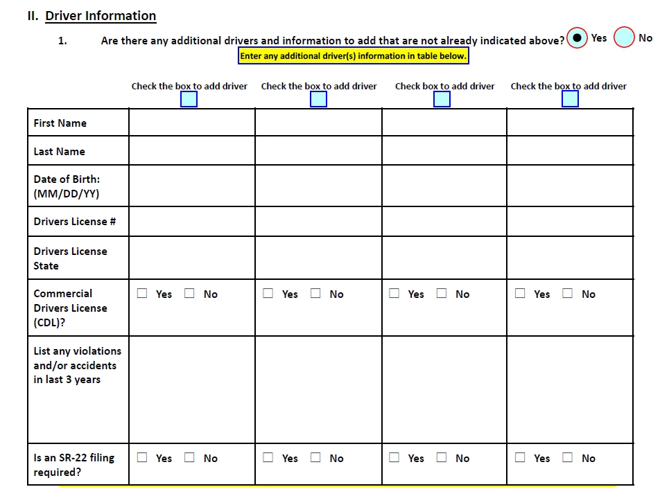

I'm having the same issue as original thread.
On my form I have a check box to add a driver and driver information to the form.  When the box is checked it makes specific fields visible to fill out, but then become hidden when box is unchecked.  The default state of the checkbox is "unchecked".
I want the user to be able to after having "checked" the box and filled out the requested data into to the visible fields to be able to have the option to "uncheck" the box and clear/reset the responses entered in any/all of the displayed fields if say they entered data in error or just changed their mind.  But once the user attempts to "uncheck" the box I want an alert pop up to with a reset warning alert to appear so they can confirm they indeed wish to remove driver.  The message reads: "Are you sure you want to remove and delete this driver info?"
My issue is I can't seem to get the "No" response to "Are you sure you want to remove and delete this driver info?" warning pop-up to cancel the reset action and return back to the form.  Both actions in the alert box "Yes" or "No" are reseting the form.  Can anyone help review my mouse up event script to see where the error is or how to fix that
My issue is I can't seem to get the "No" response to "Are you sure you want to remove and delete this driver info?" warning pop-up to cancel the reset action and return back to the form.  Both actions in the alert box "Yes" or "No" are reseting the form.  Can anyone help review my mouse up event script to see where the error is or how to fix this issue.  Many Thanks!
