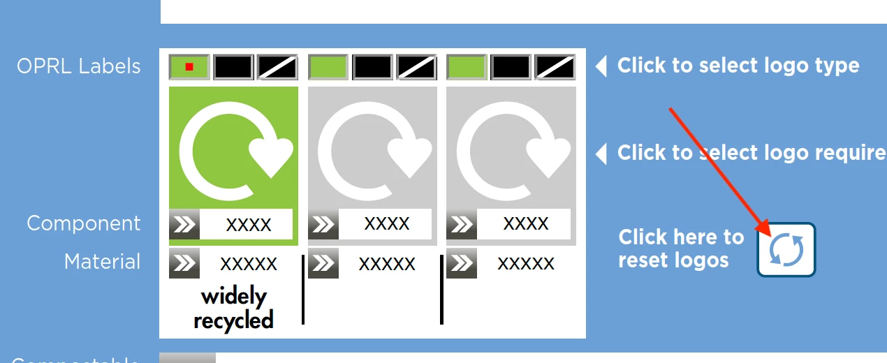

I'm trying to setup a button to turn off 9 layers on an interactive pdf form.
8 out of 9 of the layers turn off no problem but the 1 layer remains turned on. Really not sure why this is happening. Double checked obvious things like layer names but to no avail. The WR1 layer will not turn off when I click the reset button.
Could anyone please help me with this 'simple' task as I am not particularly advanced with Javascript.

Where is the reset button?
Jan 4, 2019 12:39 PM UTC
Ideally I would like the layers to toggle on/off with the 3 small buttons above each logo but also act like radio buttons so you can only choose one at a time.
Thanks for your help.
