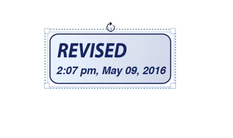

Hello! I work for a tool and die shop. We use Acrobat XI Standard to master part prints for each job. Each print has a job number, revision level, and short list of quality information that we have a dynamic stamp for. Occasionally, the information is the same for more than one job; however, I can't always copy and paste because when I do the stamp turns automatically 90 degrees. Is there any way to rotate the stamp without having to start over again? I've been searching forums and help sites for weeks and have found some solutions but they don't seem to work for me.

You can rotate a stamp - either when it's first place, or after you copy&paste it into a new document:
Select your stamp, and then place your mouse cursor over the rotation "handle" at the top of the stamp (as indicated in the screen shot above). Your cursor should change to the rotation cursor as shown. You can now drag the mouse to rotate the stamp. When you hold down the shift key while rotating, your rotation angles will be constraint to multiples of 45deg.

Hello fellow Acrobat DC subscription people, I FOUND THE SOLUTION!
With this newer version of Acrobat DC, you have to zoom out far enough (100% or lower) and the rotate icon will show up. This seems like a bug that needs to be fixed, but in the meantime this is the work around.
