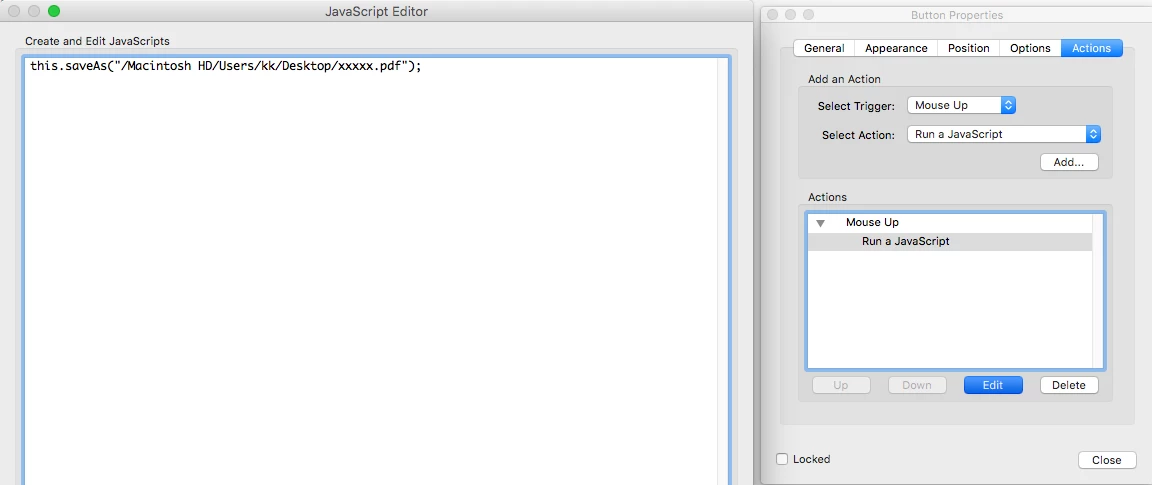

HI,
I am trying to saveAs the opened pdf in my server. Before the sever address i tried to save the file in desktop but it is not working. Could you please suggest me?
this.saveAs("/Macintosh HD/Users/kk/Desktop/xxxxx.pdf");
app.closeDoc();
another method:
this.saveAs("~/\Desktop/\/xxxxx.pdf");
app.closeDoc();

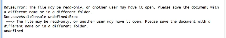

When i try to run in console it shows error like below
@Karl: I tried with this.saveAs("/Users/kk/Desktop/xxxxx.pdf"); but same error occurs

What happens when you run this code? Also, from where are you running it?
And app.closeDoc(); is not a valid command. the closeDoc method is a part of the Document object. Use this instead:
this.closeDoc();
If you want to know the correct syntax for the file-path of a specific file, open it in Acrobat and then execute this code in the JS Console:
this.path;
It will print out the full path of current file, in the syntax that you need to use in your code.

Thanks for your reply. Nothing happen. I am using this script with SUBMIT button. While i am pressing i need to save a copy of file to specific path.
Yes i tried the app.alert(this.path) method to know the location and used the same in the code (
  1. this.saveAs("/Macintosh HD/Users/kk/Desktop/xxxxx.pdf");
Karthi

You can't use this command from a button just like that. It needs to run from a trusted context, e.g. a folder-level script.
If you check the JS Console (Cmd+J) you'll see an error message there saying that the method failed for security reasons.
