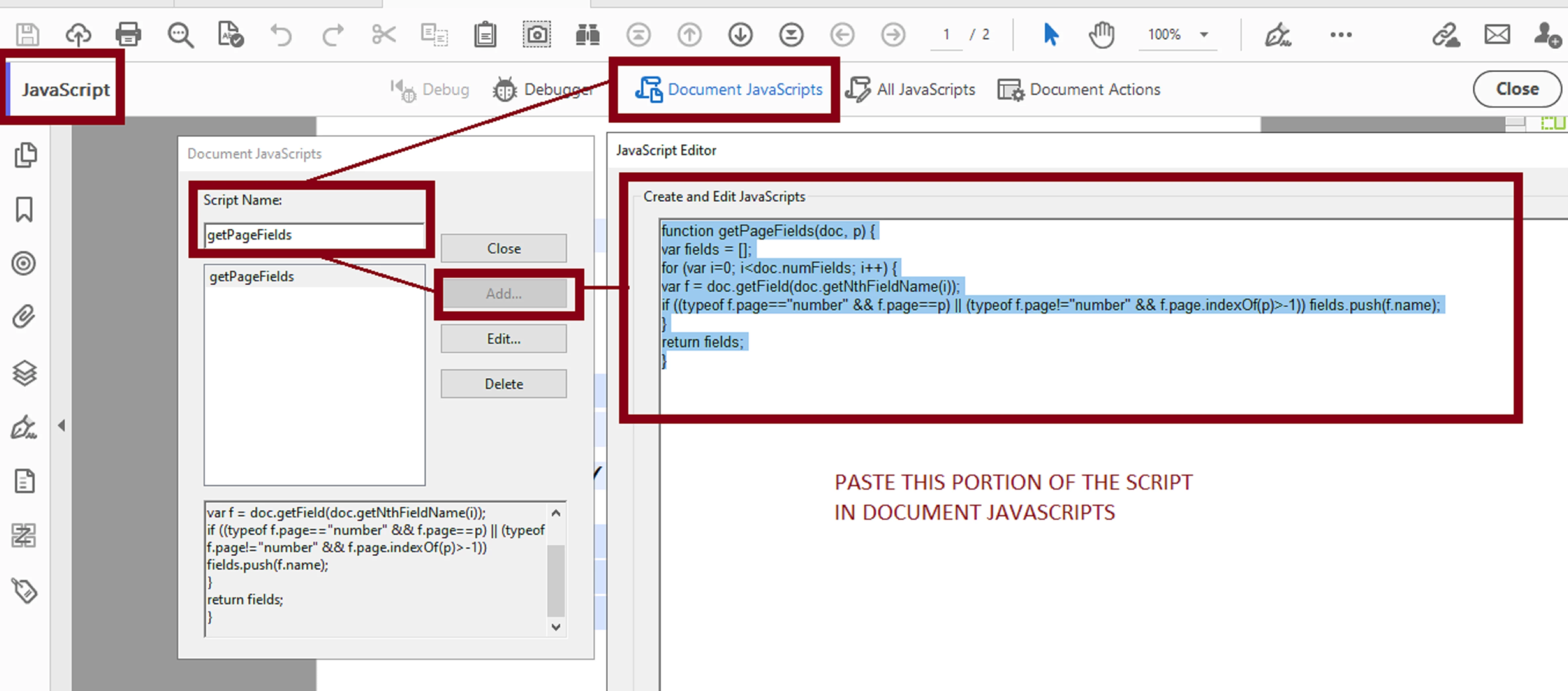

This is a document level script.
The first part of the script is declaring a function, which is  what you currently posted from that link.

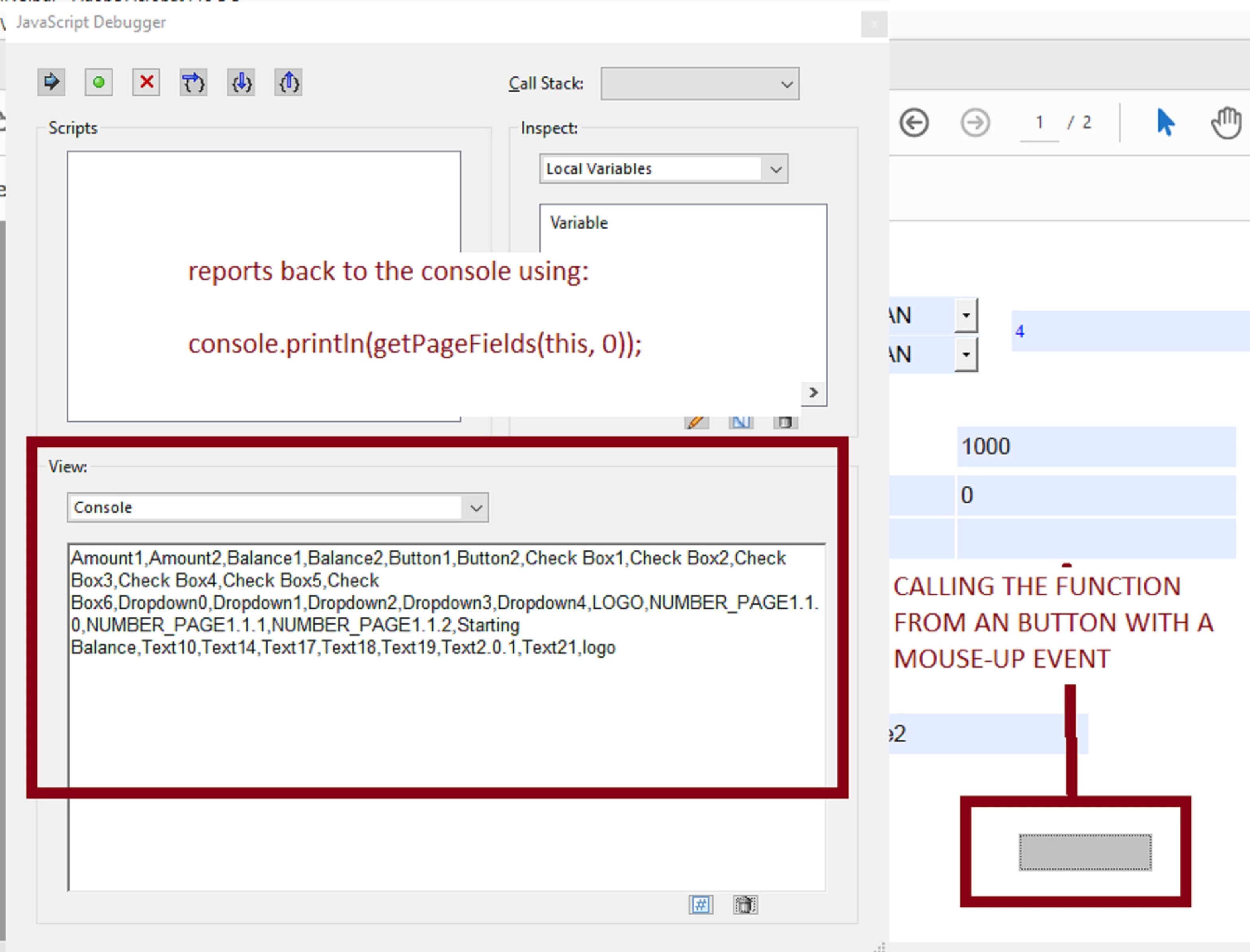

The second part of the script has to call this function. You need to call the function using this other script:
getPageFields(this, 0);
In my example slides below I  used the JavaScript tool --->> Document Scripts to create the function.
Then I added a button with a Mouse-up event to call the function and report back to the console with this line:
console.println(getPageFields(this, 0));
The results look like shown below when I call the function from the button and open the console:
