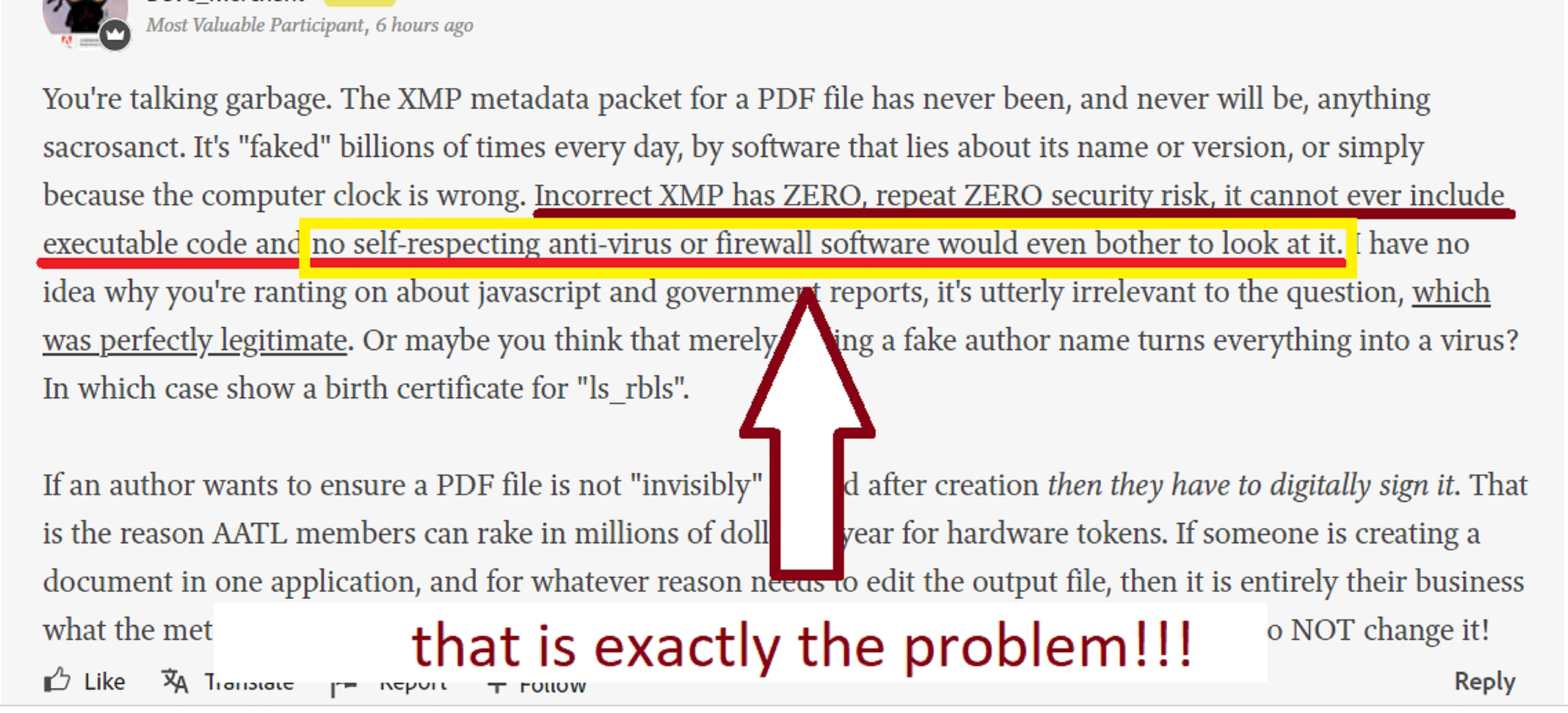

  • Incorrect XMP has ZERO, repeat ZERO security risk, it cannot ever include executable code and no self-respecting anti-virus or firewall software would even bother to look at it.
Again, did you just said that???? specially the part that says "no self-respecting anti-virus or firewall software would even bother to look at it."
See the slide below. Maybe handing to you my narcissistic mirror can help pull out the veil in front of you and actually aid you to see the same reflection that I'm looking into:

I assume my post earlier didn't came out right. But look at the slide that I posted above again, please do.
The fact that you actually asked if I think that adding a fake author turns everything into a virus really shows another great compliment. Thank you Dave!
Since now you brought to the forum's attention about XMP (NOT ME!) you should defiinitely look in how XMP IDs and XMP Pivots are used in malware campaigns precisely because of low anti-virus detection rates.
